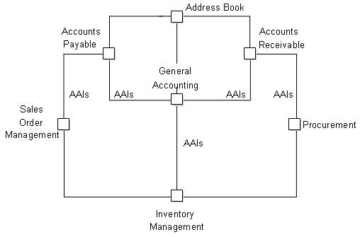

The following graphic illustrates how the Procurement system integrates with JD Edwards World accounting systems and other JD Edwards World distribution/logistics systems.
Figure 1-1 Integration of the Procurement System
The Procurement system integrates with the General Accounting and Accounts Payable systems. With the use of automatic accounting instructions (AAIs) and user-input account numbers, the system relays pertinent transaction information to your accounting systems.
The Procurement system retrieves supplier payment information, tax information, and so forth from the Accounts Payable system.
The Procurement system works in close coordination with the Address Book system to retrieve:
Supplier address information
Ship-to address information
Warehouse address information
User identification information
Your company might integrate the JD Edwards World Procurement system with the JD Edwards World Inventory Management system. This integration involves the validation and exchange of information that pertains to inventory items.

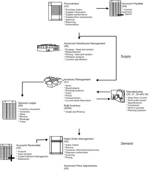

The following graphic illustrates how the Procurement system interacts with other systems to meet supply and demand requirements in a stock based distribution/logistics environment.
Figure 1-2 How Procurement Interacts with Other Systems to Meet Supply and Demand

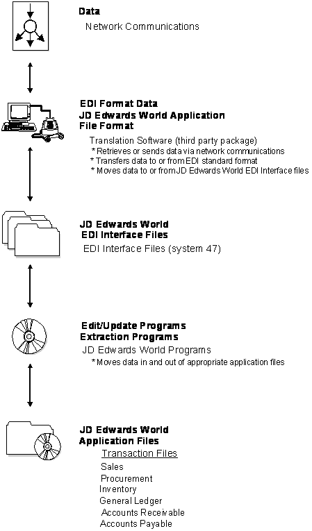

Electronic Data Interchange (EDI) is the computer-to-computer exchange of business transactions, such as purchase orders, invoices, and shipping notices, in a standard format that most computers can process.
The Electronic Commerce system consists of JD Edwards World System 47, which is the application interface containing interface files and programs. System 47 works with third-party translation software that translates EDI standard data into a JD Edwards World file format, so that the JD Edwards World application software can manage the data.
When you receive documents, your third party translator software:
Retrieves the data via network communications
Translates the data from EDI standard format to JD Edwards World application file format
Moves the translated data into the JD Edwards World EDI interface files
The JD Edwards World Electronic Commerce system then moves the data into the appropriate application files.
When you send documents, the system performs the procedures above in reverse order. The following graphic illustrates the EDI process:

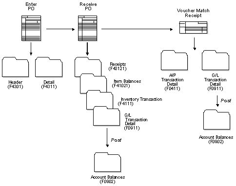

The following graphic shows the files that are affected as a purchase order flows through the purchasing process.
Figure 1-4 Files Affected by the Purchasing Process

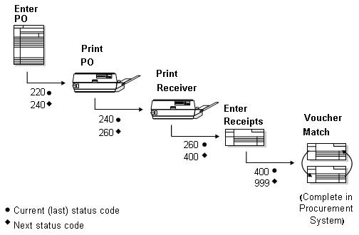

You must set up order processing cycles to indicate how the system is to process the detail lines on each of your order types (purchase orders, requisition, blanket orders, and so forth). For example, you can set up the processing cycle for purchase orders as follows:
Create purchase order
Print purchase order
Print purchase receiver
Receive goods or services
Create voucher
You use order activity rules to set up the required steps for a processing cycle and to indicate the progression of the steps. You must assign a current and next status code to each step in the process. These codes identify the current status of an order detail line and the next step to which the system advances the line.
Figure 1-5 Purchase Order Processing Cycle
For each processing cycle you set up, you must specify the order type and line type to which it applies. For example, the processing cycle shown above might only apply to purchase order detail lines to which you assign a line type of S.

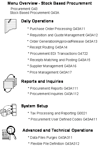

Figure 1-6 Menu Overview - Stock Based Procurement

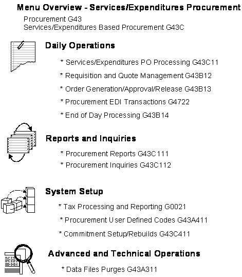

Figure 1-7 Menu Overview - Non-Stock Based Procurement

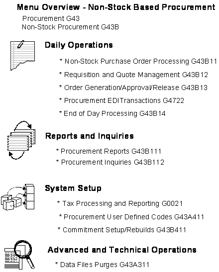

Figure 1-8 Menu Overview - Services/ Expenditures Procurement
