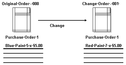

You can have the system create a change order each time you enter or modify a purchase order. For example, if you enter an order for 5 gallons of blue paint, the system creates change order 000. If you modify the order to 7 gallons of red paint, the system creates change order 001. You can locate change order 000 to review the information on the original purchase order. You can locate change order 001 to review information on the current purchase order, including the fields modified.
When you review a purchase order, the last change order that was created appears. The number of revisions to each detail line also appears.

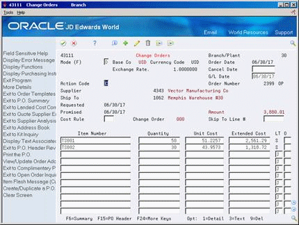

Inquire on a specific purchase order number.
Change one of the following fields on a detail line and press Enter:
Item Number
Account Number
Quantity
Unit Cost
Extended Cost
Review the following fields:
Change Order (Change Order Number)
Rev (Revision Number)
| Field | Explanation |
| Change Order | The number of times this purchase order has been modified. You can locate a specific change order number to review the fields that were modified. |
| Rev | The number of times this detail line has been revised. |

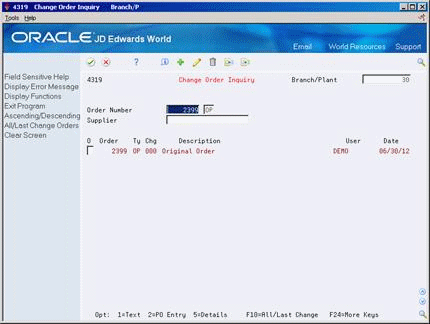

To review change order information
On Change Order Inquiry (P4319)
To locate change orders for a specific purchase order, complete the following fields:
Branch/Plant
Order Number
Supplier
If you entered notes for a change order, the first line of the notes display next to the change order number.
Review the following field:
Chg (Change Order Number)

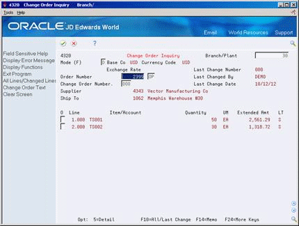

Type 5 in the following field next to the appropriate change order number to access Change Order Inquiry (P4320):
Figure 30-4 Change Order Inquiry (Option Exit) screen

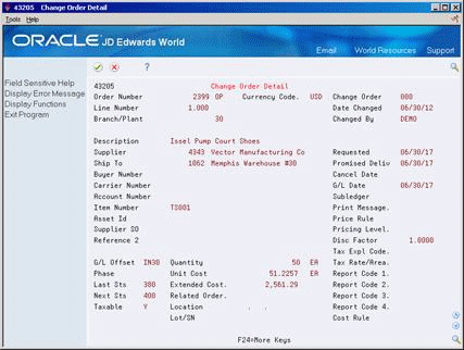

Review the detail lines modified for the change order.
On Change Order Detail, review the fields modified for the detail line.
The system highlights those fields that were modified.

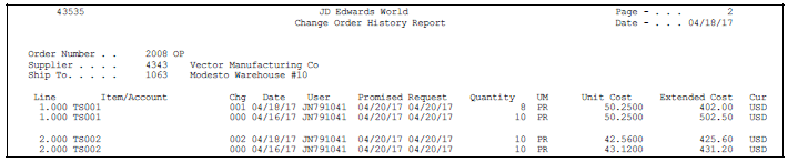

From Stock Based Procurement (G43A), choose Procurement Reports
From Procurement Reports (G43A111), choose Print Change Order History
You can print the Change Order History report (P43535) to review information about change orders. The report lists the following information:
