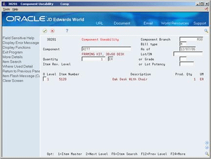

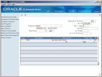

Use the Component Useability program to display the quantity of a parent item that can be produced based on the component quantity. The system adjusts the production quantity in relation to the component quantity. This is useful in determining what can be produced based on component material on hand. You can restrict the data that is displayed to a specific lot, grade, or potency of the item.

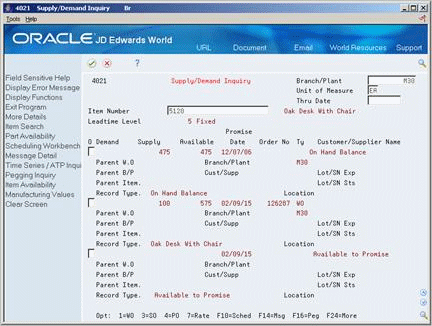

Use the Supply/Demand program to show the demand, supply, and available quantities for an item in your inventory. You can access other forms to confirm detail information on work orders, parts lists, purchase orders, and sales orders. The information is interactively displayed from Purchase Order Management (system 42), Shop Floor Control (system 31), and Sales Order Management (system 43).
Use the processing options in this program to:
Include both supply and demand planned orders from the MPS/MRP/DRM Message table (F3411).
Include forecast demand from the Forecast table (F3460).
Display an Available to Promise line that calculates the units available for sale or distribution before the arrival of future supplies.
Display a Cumulative Available to Promise line that calculates the running total of Available to Promise.
Specify which version of associated DREAM Writer programs are used when you access the programs. You should use the same program version for each Distribution Requirements Planning generation you run to ensure that your data is consistent between systems.
Set up different versions of inclusion rules to include the document type, line type, and status of each purchase order, sales order, or work order. This program's processing option for the Supply/Demand Inclusion Rules must contain a valid version of inclusion rules from the MPS/MRP Resource Rules table (F34004). You should set this option to use the same version that you use in your Distribution Requirements Planning generation in order to facilitate tracking among the systems.

To review component useability
From Shop Floor Management (G31), choose Daily Order Preparation - Discrete
From Daily Order Preparation - Discrete (G3111), choose Component Useability
Complete the following fields:
Component
Quantity
The following fields display component information:
Item Number
Production Quantity

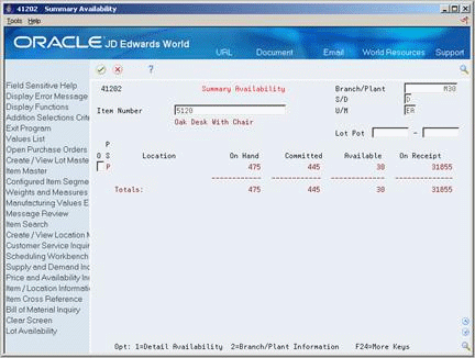

To review summary availability
From Daily Order Preparation - Discrete (G3111), choose Summary Availability
Complete the following field:
Item Number
The following fields display item information:
Primary/Secondary Storage Location
Location
On Hand
Committed
Available
On Receipt
| Field | Explanation |
| P S | A value that indicates if this is the primary or secondary location for this item within this stocking location. Valid values are:
P – Primary storage location S – Secondary storage location Note: You can only have one storage area within each branch or warehouse marked as primary. In some cases, the system uses the primary storage area as the default. |
| Totals: | The total quantity committed to a specific location. The total is calculated from the following fields:
| On Receipt | The total number of items on receipt for a specific location. The total is based on the total number of items entered in the Quantity on Purchase Order Receipts and the Quantity on Work Order Receipt fields. |

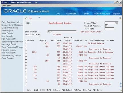

To review supply and demand information
From Daily Order Preparation - Discrete (G3111), choose Supply/Demand Inquiry
Figure 23-5 Supply/Demand Inquiry screen (Detail area)
On Hand Balance
Parent Work Order

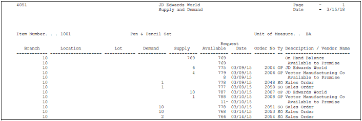

From Shop Floor Management (G31), choose Periodic Functions - Discrete
From Periodic Functions - Discrete (G3121), choose Supply/Demand
The Supply and Demand report shows the supply, demand, and available quantities for an item. This report can include quantities of materials in:
On-hand inventory
Safety stock
Sales orders
Purchase orders
Work orders
MPS/MRP planned orders
Forecasts
Rate schedules
The information on this report and the processing options used to generate it are the same as on Supply/Demand Inquiry.

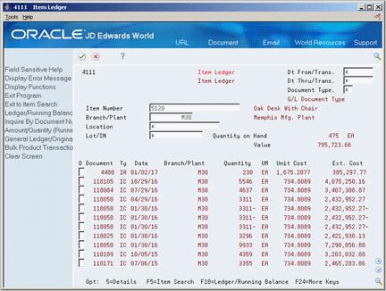

Use the Item Ledger program to display a detailed history of the transactions that have occurred for an item. The transactions include:
Inventory issues, adjustments, and transfers
Sales posted after sales update
Purchase receipts
Manufacturing completions and issues
Physical inventory updates
You can limit the date displayed by entering values in any of the header fields. You can toggle between transaction dates (running balance) and general ledger dates for items and set a default display in the processing options.
Because the dates in the item ledger and running balance might differ for an item, the values displayed might also differ.
Reviewing item ledger information includes the following tasks:
Reviewing cost information
Reviewing quantity information in running balance format
Reviewing cost information in running balance format
Item Number
Branch/Plant
Location
Lot
Date From
Date Through

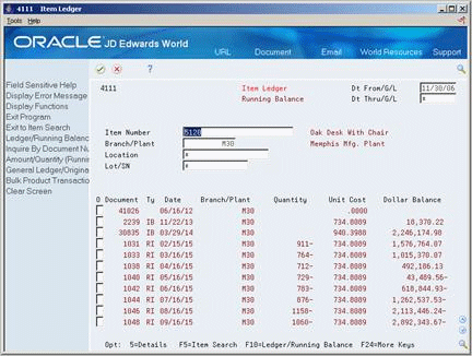

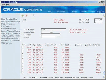

To review quantity information in running balance format
On Item Ledger (The CARDEX)
Change the format to Running Balance.
Figure 23-8 Item Ledger screen with Running Balance Format

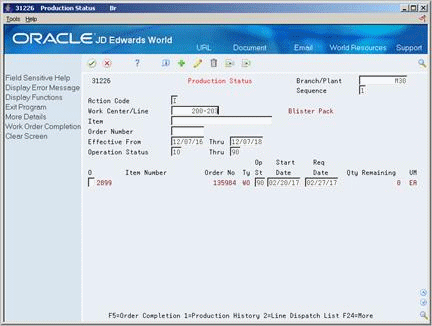

Use Production Status to view the status of all work orders by work center, production line, and item, within the status and date ranges. The system shows historical information as well as open orders.

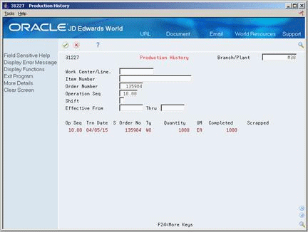

From the Production Status form you can access the Production Transaction History form, where you can view a record for each entry of completions and scrap at an operation.
On Production Status
Work Center/Line
Item Number
Branch/Plant
To view the various transactions reported against an order, choose Production History.

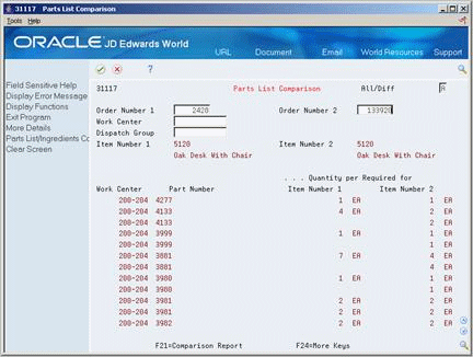

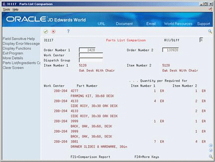

Use Parts List Comparison to view the different items and quantities of two parts lists. You can display all items for the two parts lists or only the differences. In addition, you can limit displayed data to a specified work center or dispatch group.
Before You Begin
Attach the components to an operation on the routing to view these components
| Topic | Description |
| Modes of display | This program has two modes of display you can use to locate information:
1 = Display all components 2 = Display only differences between the two parts lists If you leave the mode blank, the mode of display is the differences between the two parts lists. |
| Printing a report | Use the appropriate selection to print the parts list comparison in report form. Use the processing options to specify work orders, the mode to print, and a work center, a dispatch group, or both. |
To review parts list comparison
On Parts List Comparison
Figure 23-12 Parts List Comparison screen
Complete the following fields to locate all components of your work orders:
Work Order 1
Work Order 2
Access the detail area.
Figure 23-13 Parts List Comparison screen (Detail area)
Review the part descriptions.
