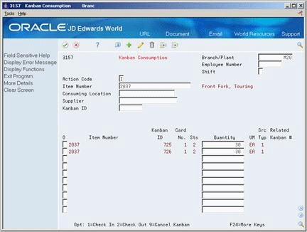

Kanban Consumption allows you to access all kanbans at a given consuming location. After you locate your items, depending on the status of each item, you can make one of the following status changes at a consuming location:
Checked-in (1)
Checked-out (2)
To process kanban consumption by item
Complete the following fields:
Item Number
Branch/Plant
Access the detail area.
Figure 22-2 Kanban Consumption screen (Detail area)
To check in the item, enter a 1 in the following field next to the item number:
Option
Quantity may also be modified
Complete the following fields if checking in a kanban that was supplied by the production line which included the creation of a rate or work order:
Employee Number
Shift
To check out the item, enter a 2 in the following field next to the item number:
Option

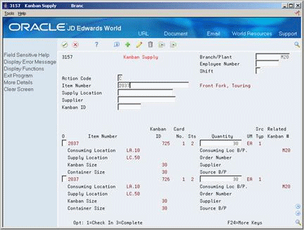

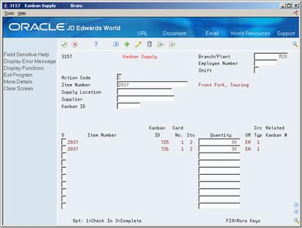

Kanban Supply allows you to access all kanbans that need replenishment for items stored or produced at a given supplying location. After you locate your items, depending on the status of each item, you can make one of the following status changes at a supplying location:
Checked-in (1)
Completed (3)
Inventory and statuses are affected as follows:
One-phase - inventory is immediately received and available at the consuming location, and the status is changed to checked-in (1).
Two-phase - the completion and transfer are reported separately:
The quantity is completed to the supplying location, the kanban status is changed to a complete (3).
After the quantity has physically been received at the consuming location, a transfer is performed from the supply location to the consuming location and the kanban status is changed to checked-in (1).
To process kanban supply by item
Item Number
Branch/Plant
Figure 22-4 Kanban Supply screen (Detail area)
Option
Employee Number
Shift
To complete the item, enter a 3 in the following field next to the item number:
Option

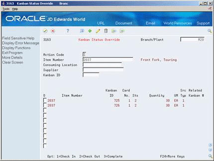

Should you find that a kanban card is not at the correct status, you can bypass normal kanban processing and change the status using the Kanban Status Override program (P3163). This will only update the status on the kanban and not perform any associated processing. This program has been placed on an advanced menu since it should only be used for remedial purposes by authorized users.
If all kanban card records are updated to the same status, the program will also update the status on the Kanban Master record.
To process kanban status overrides
On Kanban Status Override
Figure 22-6 Kanban Status Override screen
Complete the following field:
Option
You can use the processing options to control which status codes the program is allowed to update.
