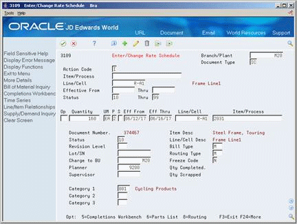

To enter rates
On Enter/Change Rate Schedule
Figure 21-1 Enter/Change Rate Schedule screen
Description of Figure 21-1 follows
Description of "Figure 21-1 Enter/Change Rate Schedule screen"
  1. Complete the following fields:
    • Item Number
    • Branch/Plant
    • Rate Quantity
    • Effective From
    • Effective Through
    • Line
  2. Complete the following optional fields:
    • Period
    • Shift

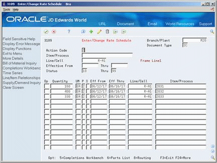

  3. Access the detail area.
    Figure 21-2 Enter/Change Rate Schedule screen (Detail area)
    Description of Figure 21-2 follows
    Description of "Figure 21-2 Enter/Change Rate Schedule screen (Detail area)"
  4. Complete the following optional fields and press Enter:
  • Status
  • Freeze Code
  • Category 1
  • Category 2
  • Category 3
  • Bill Type
  • Routing Type
