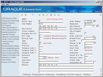

To close a work order without deleting it from the system, you change the status of the order.
To change the status of a work order to "closed"
On Enter/Change Order
Complete the following fields:
Order Number
Status
See Section 35.1, "Manufacturing Work Order Entry (P48013)."
