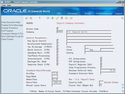

Before you can enter step progression information, you must activate automatic step progression in your company constants. When you activate automatic step progression, you specify how the system will update step progression history.
To set up step progression in the company constants
On Payroll Company Constants
Figure 24-1 Payroll Company Constants screen
Locate company 00000.
Complete the following field:
Step Progression Process

| Step Progression Process | A code that specifies whether the system updates Step Progression History tables and the level of detail in which the update occurs. Valid values, based on the information in the Employee Master table (F060116) are:
1 – Update using Union, Job Type, and Job Step 2 – Update using Home Business Unit, Union, Job Type, and Job Step N – Do not update the Step Progression History tables For the system to apply step progression, you must also do the following:

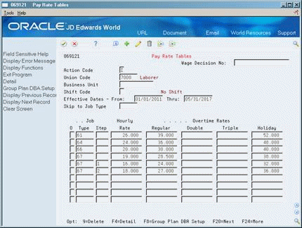

You can associate pay rates with job steps so that employees within the same job type can be paid different rates. To use the automatic step progression feature, you must enter separate pay rates for each job step within a job type, or for each job type only. If you have already set up your Pay Rate Table, verify that it contains an entry for each job step or job type.
To enter pay rates for step progression
On Pay Rate Tables
Complete the steps for setting up pay rates.

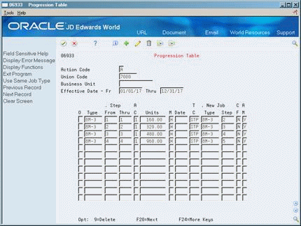

To use the automatic step progression feature, you must complete the progression table to define the number of units (in hours or days) that an employee must work to progress through each job step. The pre-payroll and interim check entry programs read the progression table and step progression history to determine an employee's time and grade status. When an employee completes the specified number of hours or days in one job step, the system updates the employee's record to the next job step.
The step progression feature does not change the hourly rates entered for employees on Employee Entry. Instead, it indicates the hourly rate to use on the pay rates table for timecards.
You should enter time limits for job steps after you enter the pay rates for step progression. The job types and steps you enter in the progression table must match those you entered on the pay rates table.
Add a code to the user defined code table 07/IP to define the pay types to include when calculating hours or days for step progression
Define a range of pay types in the Worker's Compensation table that use the pay types you set up for step progression, for example, STP
To enter time limits for job steps
Complete the following optional fields:

Complete the following fields:
Date- Beginning Effective
Date - Ending Effective
To specify units for the current job type or step, complete the following fields:
Job Type
Accumulator Code (AC)
Units - Total
Step Progression Method (M)
Based From Date
Insured Pay Table Number (TC)
If you are using job steps, complete the following field:
Job Step
To specify information about the next job type or step, complete the following fields:
Job Type at Next Level
Carry Over Flag (CF)
Movement Flag (AM)
Complete the following optional field:
Job Step at Next Level
| Field | Explanation |
| A C | A code that specifies whether the total number of units entered represents units worked in a designated job type or in a job type and step combination. Valid codes are:
1 – The units entered represent the total number of units that the employee must work within the designated job type and step combination before advancing to the next job type and step. 2 – The units entered represent the total number of units that the employee must work within the designated job type before advancing to the next job type. If you enter a code in this field, leave the Date field blank. |
| Units | The total number of units (Hours/Days) an employee must work in a job. |
| M | A code that specifies the method the system uses to calculate step progression units. Valid codes are:
H – Hours D – Days |
| T C | A code that identifies a table of pay, deduction, and benefit types that define the basis for various payroll calculations. These tables are used in several different processes, such as defining insured pay types for workers compensation and identifying pay types to be included in automatic timecard generation, step progression processing, and retroactive pay processing.
Step progression processing uses valid pay types from the Workers Compensation Table. You can add a code to the user defined code list (07/IP), then use that code to define a range of pay types in the Workers Compensation Table (for example, STP for Step Progression). The Step Progression table uses the range of defined pay types to determine when an employee has met the step progression requirements and automatically moves to the next step. |
| C F | A code that specifies whether the total accumulated units (number of hours per day) or only the excess units (number of hours per day that exceed the required amount) are to be carried over to the employee's next job type/step combination in the Step Progression History table.
Enter one of the following: N – Do not carry the accumulated units into the next job type or step, only the excess. Example: If an employee has a total of 520 hours and moves to the next job type or step, the new accumulated hours are 20. Y – Carry all accumulated units into the next job type or step Example: If an employee has a total of 520 hours and moves to the next job type or step, the new accumulated hours are 520. |
| A M | A code that specifies whether an employee's move to the next job type or step is done automatically or manually.
Valid values are: Y – The system automatically moves employees to the next job type or job step (default) N – You must manually move employees to the next job type or job step |

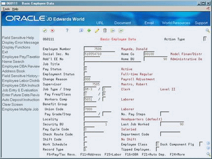

To include an employee in automatic step progression processing, you must enter the employee classification for step progression. You must also enter specific job and pay information for the employee. This information includes a job type and job step that match one of the job types and job steps you entered when you set up time limits.
To enter step progression information for an employee
On Basic Employee Data
Complete the steps for entering basic employee data.
Employee Class
Job Type
If you use job steps, complete the following field:
Job Step
| Employee Class | A code that represents the employee's classification status. Valid values are:
Y – Contract labor (non-employee) N – Regular employee S – Employee to be included in step progression process |
