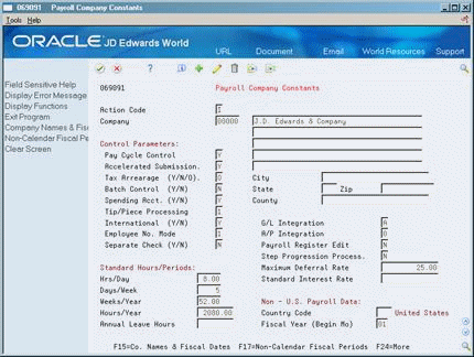

To set up payroll company constants
On Payroll Company Constants
Figure 19-1 Payroll Company Constants screen
Locate company 00000.
Complete the following field:
A/P Integration
| Field | Explanation |
| A/P Integration | This field specifies the level of integration between the Payroll and the Accounts Payable systems. The system creates pro forma vouchers during the payroll journal entries step of the payroll cycle. The system creates actual vouchers during the final update step.
N – No integration 0 – Create vouchers for both DBAs and taxes that have been setup with A/P integration 1 – Create vouchers only for DBAs that have been setup with A/P integration 2 – Create vouchers only for taxes that have been setup with A/P integration |
You must set up vouchering to use your Payroll system to create vouchers for tax transactions. After you activate A/P integration for taxes, the system creates vouchers for those tax types.

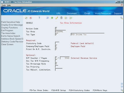

To use your Payroll system to create vouchers for tax transactions, you must activate vouchering for tax types. The system creates vouchers only for the tax types with active vouchering. For federal A and all state and local taxes, specify a payee. You must activate vouchering for other types of federal taxes, but do not need to specify a payee.
To use your Payroll system to create vouchers for tax transactions, you must activate vouchering for tax types. The system creates vouchers only for the tax types with active vouchering, as follows:
For U.S. Payroll, you must also specify a payee for Federal A and all state and local taxes. You do not need to specify a payee for other federal tax types.
Typically, you enter a payee at the tax type level when all or most of the companies in your organization remit a tax to the same taxing authority. You can override this payee at the company level, if necessary.
To activate vouchering for tax transactions
On Tax Area Information
Complete the following fields to locate a tax type:
Tax Area
Tax Type
A/P Voucher
Complete the following optional field:
Payee
| Tax Area | A code that identifies a geographical location and the tax authorities for the employee's work site. Authorities include both employee and employer statutory requirements. In Vertex payroll tax terminology, this code is synonymous with GeoCode. Refer to Vertex System's Master GeoCode List for valid codes for your locations. |
| Tax Type | A user defined code (07/TX) that identifies the type of payroll tax being processed.
Refer to the associated user defined code records for the current descriptions of these codes. The values and meanings associated with this user defined code are pre-set by JD Edwards World. You should not alter the values and meanings. Form-specific information For Canadian provincial tax types: Set up tax type CF for every tax area even if there is no provincial tax because wage history is maintained by province. For U.S. state tax types: Set up tax type C, Federal Unemployment Insurance (FUI) for each state, because the FUI rate might vary from state to state. Use the 2 character statutory code for the state. You must have the tax type Z, weeks worked, whenever you have tax type H, state unemployment. Some states require weeks worked to be reported with state unemployment. For U.S. local tax areas: Local tax areas use all 9 digits of the GeoCode tax area. You should define a 3 character statutory code. For U.S. Earned Income Credit (EIC) For Tax Type B, the EIC prints on the check, advice, or pay slip. The system subtracts this tax amount from the total deductions at the bottom of the pay stub. |
| A/P Voucher (Y/N) | The Yes or No Entry field is a common single character entry field for simple yes or no responses on prompt forms.
Form-specific information Indicates whether the system creates a voucher for this payroll tax in the Accounts Payable system. |

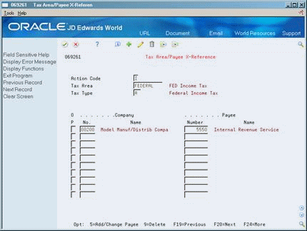

From Payroll Master (G07), enter 29
From Payroll Setup (G074), choose Taxes and Insurance
From Taxes and Insurance (G0744), choose Tax Area/Payee Cross-Reference
After you activate vouchering for tax types, you can enter tax payees at the company level. Entering payees at the company level is optional. You do so only in one of the following circumstances:
You did not enter a payee at the tax type level.
You entered a payee for the tax type that differs from the payee for the company.
The payees you enter at the company level override the payee you enter at the tax type level. You can enter multiple companies and assign one payee per company for each tax type and tax area.
To enter tax payees by company
On Tax Area/Payee Cross Reference
Figure 19-3 Tax Area/Payer Cross-Reference screen
Tax Area
Tax Type
Complete the following fields:
Company Number
Payee Number

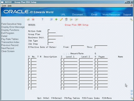

From Pay/Deductions/Benefits (G0742), choose Group Plan DBA Setup
After you set up vouchering for a DBA, you can enter voucher information when you include the DBA in a group plan. You can include a DBA, such as a union dues deduction, in multiple group plans.
Because you might need to create vouchers for some group plans and not others, you can choose to deactivate vouchering for the DBA at the group level.
For a DBA that is assigned to multiple group plans, the payee might vary between groups. Therefore, you can enter payees for the DBA at the group plan level. The payee you enter for a group plan overrides the payee entered at the DBA level.
You enter a payee for a group plan only in one of the following circumstances:
You did not enter a payee at the DBA level
You entered a payee in the setup for the DBA that differs from the payee for this group plan
To enter voucher information for group plans
On Group Plan DBA Setup
Complete the following field to locate the group plan for which you need to create vouchers:
Group Plan
Generate Voucher (GV)
Payee
| G V | A code used to determine whether the system should generate a voucher for the DBA, tax, or wage attachment during the final update phase of the payroll processing cycle. Valid codes are:
N – No, do not generate a voucher Y – Yes, generate a voucher |

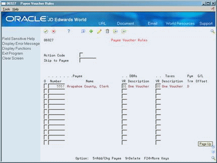

From Payroll Setup (G074), choose Pay/Deductions/Benefits
From Pay/Deductions/Benefits (G0742), choose Payee Voucher Rules
You use payee voucher rules to specify how the Payroll system summarizes detailed transactions into vouchers during the journal entries step of the payroll cycle.
Payee voucher rules for DBAs include:
| Rule | Description |
| Voucher Rule 00 | One voucher per payee. This is the default rule.
Use this rule to summarize all DBA transactions, regardless of DBA, employee number, or group plan. When the system summarizes transactions, different general ledger account numbers result in separate pay items on the same voucher. The account might be for different companies. |
| Voucher Rule 01 | One voucher per employee.
Use this rule for a payee for a wage attachment that you entered at the employee level. This rule is particularly useful for wage attachments, because a voucher for a wage attachment includes a payment remark with the case number from the court and the employee's last name. The Accounts Payable system prints the remark for each voucher, even when multiple vouchers are included in one payment. |
| Voucher Rule 02 | One voucher per payee for each DBA. |
| Voucher Rule 03 | One voucher per payee/EE/DBA |
| Voucher Rule 04 | One voucher per payee for each group plan.
Use this rule for a payee that you entered at the group plan level. |
Payee voucher rules for taxes include:
| Voucher Rule 00 | One voucher per payee. This is the default rule. Use this rule to summarize all tax transactions, regardless of tax type or employee number. When the system summarizes transactions, it creates separate pay items fro different general ledger account numbers on the same voucher. |
| Voucher Rule 01 | One voucher per payee by employee. |
| Voucher Rule 02 | One voucher per payee by tax type. |
To summarize all of your vouchers according to rule 00, do not set up any payee voucher rules. The system creates:
One DBA voucher per payee
One tax voucher for each of the payee's corporate tax IDs
To use a rule other than rule 00 for a payee, you must specify both a DBA rule and a tax rule for the payee. When you specify only one rule for a payee (either a DBA or a tax rule), the system enters the default value of zero for the other rule.
On Payee Voucher Rules
Number
DBAs Voucher Rules (VR)
Taxes Voucher Rules (VR)
Review the information in the following fields:
Payment Terms (Pym Trm)
G/L Offset
| Payee Voucher Rule | Payee Voucher Rules determine the level of summarization for a payee. This specific rule tells the system how to summarize voucher information for a DBA. For example, the rule indicates whether the system should create one voucher for a payee or create a separate voucher for each DBA owed to a payee.
The Payee Voucher Rules are predefined and should not be changed. |
