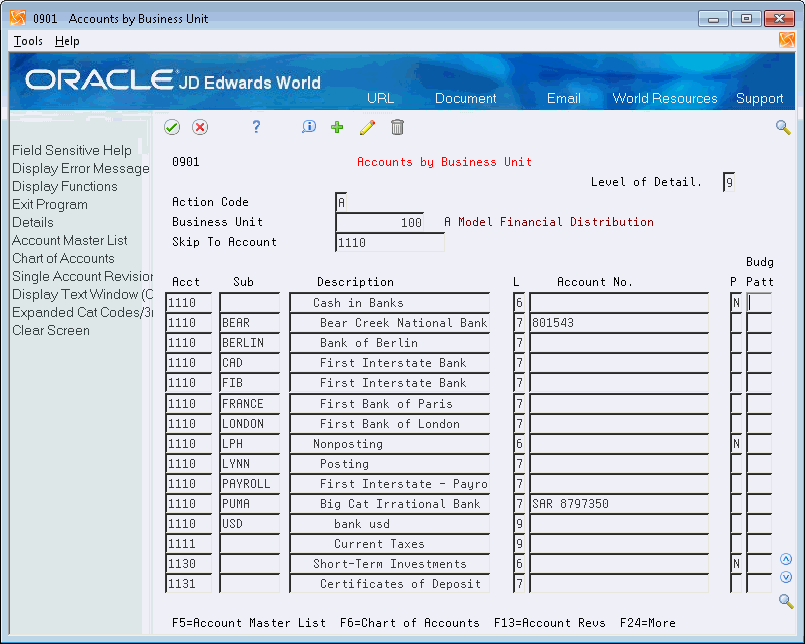

You must also set up the Short Account ID for the appropriate business unit in Accounts by Business Unit and set up UDC table 06/BK to establish the relationship between the short account ID and your bank account number.
From General Accounting (G09), select Organization & Account Setup
From Organization & Account Setup (G09411), choose Accounts by Business Unit
On Accounts by Business Unit
Complete the following fields:
Business Unit
Account
Press F4 to open the fold area.
Set up the Short Account ID in the fold of the appropriate business unit.
| Field | Explanation |
| Business Unit | The business unit segment of the payroll G/L account. |
| Acct | The object account segment |
| Sub | The subaccount segment |
| Account ID | A number that identifies an account in the general ledger. This number is created by Next Numbers when you add accounts. It is commonly referred to as the "short account number" and can never be changed. |

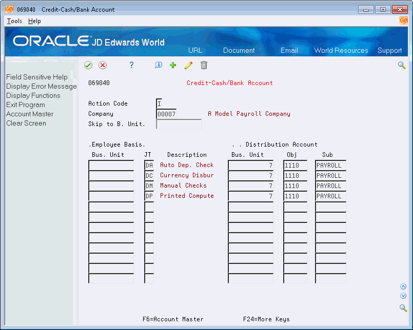

Set up cash in bank account distribution instructions to define instructions for payroll disbursements. You must, at a minimum, set up the default journal type DP. You can use other codes when other types of payments are drawn on different bank accounts.
From Payroll Master (G07), enter 29
From Payroll Setup (G074), choose Auto Accounting Instructions
From Auto Accounting Instructions (G0743), choose Credit-Cash/Bank Account
On Credit-Cash/Bank Account
Complete the following fields for each account:
Company
JT (Journal Type)
Bus. Unit
Obj (Object account)
Sub (Sub account)
| Company | |
| JT | The Journal Type for the payroll disbursement. Valid codes are:
DP – Printed computer check (Required) DA – Automatic deposit check DC – Currency disbursement DD – Interim automatic deposit DI – Interim checks DM – Manual checks |
| Description | The description of the journal type. The system fills in this information. |
| Bus. Unit | The business unit segment of the account |
| Obj | The object segment of the account |
| Sub | The subaccount segment of the account |
You can define any of the following types of accounts for payroll. You must, at a minimum, set up type DP (printed computer checks).
| JT | Description |
| DP | Printed computer check (Required) |
| DA | Automatic deposit check |
| DC | Currency disbursement |
| DD | Interim automatic deposit |
| DI | Interim checks |
| DM | Manual checks |
