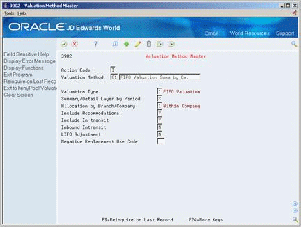

Figure 8-1 Valuation Method Master screen
Complete the following fields:
Valuation Method
Description
Valuation Type
Within Branch or Company
Include Accommodations
Include In-transit
In you are using receipts routing, complete the following field:
Include Not in Stock
If the valuation method is LIFO, complete the following field:
LIFO Adjustment
If the closing inventory quantity is negative for the period:
Negative Replacement Use Code
Field | Explanation |
Valuation Method | A two-character abbreviation for the methods that the system uses to determine the value of your company's stock for reporting and financial purposes. Examples include: FI (FIFO), F2 (FIFO Detail by Branch), and LI (LIFO).
When you run the Stock Valuation Extraction program, the system updates the Stock Valuation Detail tables for the assigned valuation methods. |
Description | A brief description of an item, a remark, or an explanation.
Form-specific information For Advanced Stock Valuation The valuation method for the code in the Valuation Method field. Examples include FIFO, FIFO Detail by Branch, and LIFO. |
Valuation Type | A hard-coded user-defined code (system 39/type VA) indicating the type of valuation method to use in stock valuation. Valid values are:
FIFO Valuation LIFO Valuation Weighted Average Valuation Replacement/Current Cost |
Summary/Detail Layer by Period | A code that indicates whether the layers are created in detail or summary mode. Valid codes are:
D – Detail mode, which creates one layer per transaction S – Summary mode, which creates one layer per: Branch, item or pool, valuation method, and period if you set the Allocation Within Branch/Company field to B (branch) Company, item or pool, valuation method, and period if you set the Allocation Within Branch/Company field to C (company) If you select S, the system's processing time depends on the size of the Item Location table (F41021). At the end of the year, the system rolls all detail layers and period summary layers into one layer. |
Allocation by Branch/Company | A code that identifies how the system allocates the historical layers built by the valuation method. Valid values are:
1 – Within company. The system creates one record per company, item or pool, valuation method, and period. Additionally, it creates records by branch that are informational only and are not posted to the general ledger. 2 – Within branch. The period detail contains one record per branch, item or pool, valuation method, and period. At the end of the year, the system rolls all detail layers and period summary layers into one layer. |
Include Accommodations | A code that indicates if you want accommodations included in this valuation method. Accommodations are the net value of loan and borrow transactions between your company and business partners. Valid values are:
Y or 1 Yes, include accommodations (default). N or 0 No, do not include accommodations. |
Include In-transit | A code that indicates if the system should include in-transit stock in the valuation. Valid values are:
Y or 1 Yes, include stock currently in transit to a customer in the calculation of stock value. N or 0 No, do not include stock that is in transit in the calculation of stock value. |
LIFO Adjustment | A LIFO adjustment removes the effect of any accumulation or depletion at the end of a reporting period. It should not be applied for the closing period of a fiscal year. You should record the LIFO adjustment against the income statement and balance sheet accounts.
The system uses the following formula to determine the LIFO adjustment: (Average cost of the accumulation/depletion - current period's average cost) * accumulation/depletion If this valuation method is a LIFO method type and set up as a company-wide method, you might want the system to calculate a LIFO adjustment. Valid values are: Y or 1 Yes, this is a company-wide LIFO valuation method. Include the LIFO adjustment calculation. This is the default. N or 0 No, this LIFO method is either layered within a branch/plant or is not company wide. Do not include the LIFO adjustment. |
Inbound In transit | Enter a Y if you wish to include products that are currently in route to your inventory but have not arrived yet in the calculation of stock value.
Enter an N if you wish not to include products in route. |
Include Not in Stock | Enter a Y if you wish to include products that are currently in route to your inventory but have not arrived yet in the calculation of stock value.
Negative Replacement Use Code | Enter the Item Pool code to indicate which costing method to use. |
