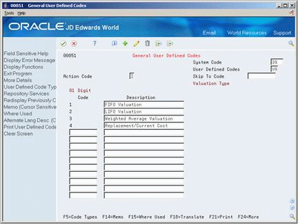

Figure 7-1 General User Defined Codes screen
Complete the following fields:
System Code
User Defined Codes
All UDCs for the system and type appear.
Review the codes already set up to confirm that they meet your business needs.
To add a new UDC or change existing codes, complete the following fields:
Code
Description
Access the detail area.
Complete the following optional fields:
Special Handling Code
Hard Coded Y/N
