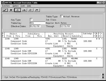

Accounting for the billing cycle is controlled by the account derivation rules. The system uses the rules to:
Identify and process workfile transactions
Direct the amount of the resulting journal entries to specific accounts
You can define two types of account derivation rules:
| Topic | Description |
| Base rules | Base rules indicate which accounts you want the system to use when it creates journal entries for the billing and revenue recognition processes. The system uses base rules to create journals for the total of the base and component amounts. |
| Reallocation rules | Reallocation rules are used to move amounts from one account to another. A reallocation rule consists of two or more offsetting journal entries that must balance. The first offset journal entry represents the reduction to the base account. The second journal entry represents the increase to the new account. |
The Journal Generation Control field in the system constants for Contract Billing controls the types of account derivation rules that you define for the following processes:

There are three types of Account Derivation Tables that the system can use to create revenue recognition and invoice journal entries. The type of journal processing that you select in the system constants controls whether the system is restricted from using a specific table type. Each applicable type must contain a base rule that defines how the system creates journal entries.

The system uses two different table types to direct the system to the base rules for the journal entries:
Table type 1 directs the system to the rules for actual revenue
Table type 3 directs the system to the rules for unbilled accounts receivable

You set up the Account Derivation Table rules for invoicing only as follows:
ACCOUNT DERIVATION TABLE TYPE 3
| Purpose | Account Basis | Tax Basis | +/- |
| Define base rule for revenue amount from the invoice | B (Base) | B (Base) | + creates a credit to the Revenue account |
| Remove cost from the Work in Process account | C (Cost) | + creates a credit to the Work in Process account | |
| Reallocate cost to Cost of Goods Sold account | C (Cost) | - creates a debit to Cost of Goods Sold account |
The RC AAI directs the system to the account information associated with the debit to Accounts Receivable.

A component is a markup that can be associated with a workfile transaction's cost, revenue, and invoice amount, or any combination of these three. If a component amount exists, an account derivation rule can reclassify the amount.
Figure C-1 Account Derivation Table (Component Reconciliation) screen
For example, a company might add 7 cents per hour onto all hourly employees' wages for the cost of benefits. When this amount is included in an invoice, the company wants the revenue amount for the benefits recovery separated from the sales revenue amount. If the current invoice included a 7 dollar billing for 100 hours, the reclassification journal entry would be:
| Reclassification | Debit | Credit |
| Sales Revenue | 7.00 | |
| Benefits Recovery | (7.00) |
To create this journal entry, you can use the account derivation rules to create a reallocation rule that reduces the sales revenue by the component amount and increases the benefits recovery. Both reallocation rules include the component name associated wit the 7 cents per hour cost of benefits so that the system can determine the recovery amount.
You can define component reallocation rules on any of the three types of account derivation tables. To reallocate components, you must determine the following:
Appropriate journal processing stage for the reallocation
Base rule associated with the component reallocation
Object account range for the workfile transaction associated with the component
Resulting accounts for the reallocation amount
Amount Basis for the component amount, such as cost, invoice, or revenue
Component code
Percentage to reallocate
To define the component reallocation rule, access the appropriate account derivation table and define the base rule. Then, define the appropriate reallocation rule to reduce the component amount from the original resulting account. Last, define the appropriate reallocation rule to increase the component amount for the new resulting account.
Reallocation rules can be dependent on the results of a conditional test. When you specify a test for a conditional reallocation rule, the system must test each condition before it can execute each account derivation rule. This additional processing increases the time it takes for the system to create the resulting journal entries.
Each conditional test can include one or more types of tests the system must execute for the Condition Code before it applies the reallocation rule. To assign a condition code to a reallocation rule, you must determine the following:
Appropriate journal processing stage for the conditional reallocation
Base rule associated with the conditional reallocation rule
Object account range for the workfile transactions associated with the conditional reallocation rule
Resulting accounts for the conditional reallocation amount
Applicable amount basis and tax basis for the conditional reallocation rule
Condition code tests
Figure C-2 Account Derivation Table (Reallocation Rules) screen
