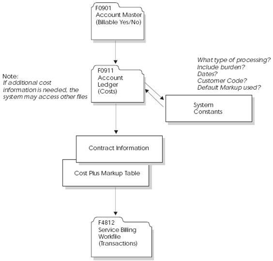

Invoices are based on billable costs. The first step in the billing process is to generate the workfile. Billable costs are represented by source transactions that the system stores in the Account Ledger table (F0911).
Source transactions originate from multiple sources, such as the Accounts Payable, Equipment/Plant Management, and Payroll systems. You run the Workfile Generation program to accumulate the cost information from these sources.
To maintain the integrity of the original source transactions, the system creates copies of the source transactions. The copied transactions are referred to as workfile transactions and are stored in the Billing Workfile (F4812).
Workfile transactions include costs with any applicable markup, taxable amounts and other key billing information. You base the rest of the Contract Billing processes on the information stored in workfile transactions.
When you run Workfile Generation (R48120) to create workfile transactions, the system performs the following actions:
Identifies all the unprocessed source transactions in the Account Ledger table (F0911)
Determines whether the account for each source transaction is billable, based on the Billable (Y/N) field in the Account Master table (F0901)
Uses related tables when constants and source transactions indicate the need for additional information, such as when burden is associated with payroll transactions
Updates the source transactions in the Account Ledger table as processed or nonbillable
Updates the Payroll Transaction History and Employee Transaction Details for all payroll-related source transactions
Calculates markup and tax amounts
Creates copies of source transactions in the Billing Detail Workfile (F4812)
Assigns appropriate eligibility codes to the copied transactions based on the Journal Generation Control option in the Billing Constants and the Billable (Y/N) field in the Account Master table
To indicate that the source transactions have been created in the Billing Workfile, the system marks the source transactions in the Account Ledger table with N (if the account is nonbillable) or Z (if the account is billable and has been processed by the billing system). The next time you run Workfile Generation, the system creates workfile transactions for only the source transactions that have not been previously included in the Workfile Generation process.

The following graphic illustrates the process the system uses to accumulate costs.
