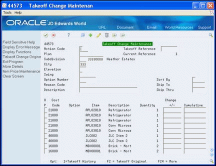

On Takeoff Change Maintenance, complete the following fields and click Inquire.
Plan
Subdivision
City
Elevation
Swing
Option Number
You can use an asterisk (*) to represent all in the Plan, Elevation, Swing, and Option Number fields.
Figure 26-1 Takeoff Change Maintenance screen
The number in the Current Reference field represents the total number of times you have made changes to items in the list in the detail area. You use this number on the Takeoff Change Original Entry (Takeoff Original) screen to view the audit trail of the change you made to the item in reference to this number.

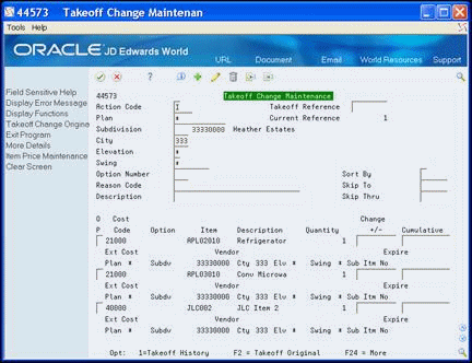

In the detail area of the screen, complete the following fields and click Change.
Change +/-
Cumulative
Choose More Detail (F4) to access the detail area.
Figure 26-2 Takeoff Change Maintenance (Detail) screen

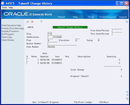

To view the changes for an item, enter 1 in the Option field next to the item and click Enter.
The Takeoff Change History screen displays the changes for the item.
Figure 26-3 Takeoff Change History screen
Click Exit (F3) to access the Takeoff Change Maintenance screen.

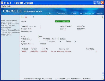

To view the audit trail of changes for an item, enter a number in the Takeoff Reference field and choose Takeoff Original (F2).
For example, if the number in the Current Reference field is 5, you can enter 1 through 5 to view the item change in reference to the number 1 through 5. Review the reference number and item association in the detail line.
The Takeoff Original screen displays an audit trail of the change for the item with that reference number.
