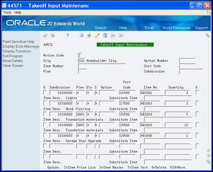

You use the Takeoff Input Maintenance screen to define a new takeoff list.
To ease the data entry process, you can enter an asterisk (*) as a wildcard, to represent all in the following fields:
Subdivision
When you enter an asterisk, the system enters asterisks to fill the entire field with asterisks
Item Number
Plan
Elv (Elevation)
S (Swing)

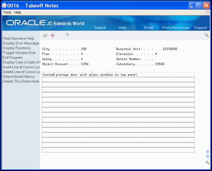

For each takeoff item, you can add a note or textual information. When text information exists for a specific item, the system highlights the Option field on Takeoff Input Maintenance.

Figure 23-1 Takeoff Input Maintenance screen
Choose More Details (F4) to access the detail area.
Figure 23-2 Takeoff Input Maintenance (Detail) screen
Enter 7 in the Option field for the specific item for which you want to add text and click Enter.
The Takeoff Notes window for the specific item displays.
Enter the text and click Enter.
Click Enter (F3) to return to Takeoff Input Maintenance.
Click Add.
The system highlights the Option field of the item with the note.
You use Takeoff Input Maintenance to change an item on the takeoff list.
On Takeoff Input Maintenance, locate your takeoff list.
Enter the information in the fields you want to change and click Change.
You use Takeoff Input Maintenance to add an item to the takeoff list.
On Takeoff Input Maintenance, complete the following fields and click Add:
