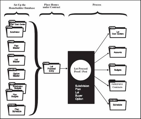

The Homebuilder Management features are divided into four phases.
In phase 1, you enter database information that the system uses in phases 2 and 3 to create contracts. See Chapter 2, "Overview to Setting Up the Homebuilder Database" for more information about phase 1.
In phase 2, you link components from the database information with a prospective buyer. See Chapter 28, "Overview to Placing Homes Under Contract" for more information about phase 2.
In phase 3, you use the information from phase 2 to create contracts and related information. The major component of this phase, and of the entire Homebuilder Management system, is the Lot Proceed Proof/Post program. See Chapter 32, "Overview to Initiating Construction" for more information about phase 3.
The following diagram illustrates the first three phases:
Figure 1-1 First Three Phases of Homebuilder Management
In Phase 4, you close the house and update bookkeeping records. See Chapter 42, "Overview to Paying Subcontractors" and Chapter 46, "Overview to Closing Homes" for more information about phase 4.
