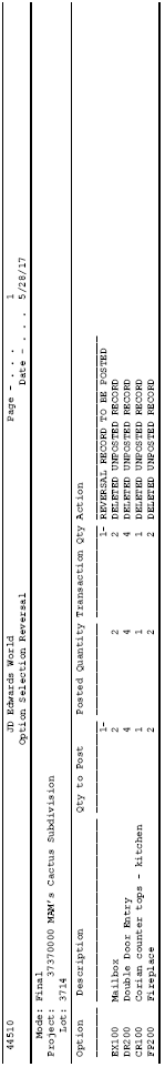

You use the Option Selection Reversal DREAM Writer program to reverse a lot (release the lot for another buyer) or to change the house plan and elevation combination. When you run Option Selection Reversal, the system creates the Option Selection Reversal report (R44510).

Figure 37-1 Option Selection Reversal report
