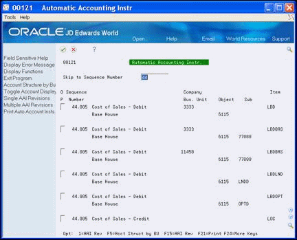

LBD AAIs are similar to LBC AAIs, except that they represent the debit side. They identify the expense account in the income statement where you charge costs. You have the option of creating additional AAIs that apply to Category Code 5, found in the detail area of the Original Budget Entry screen.
The following is an example of LBD AAIs for base house costs, land costs, and options costs.
Figure 53-2 Automatic Accounting Instructions (Lot-Based Debit) screen

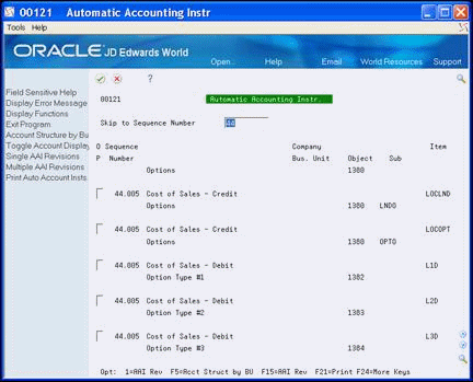

LOC AAIs apply to accounts that receive credit for options. These accounts are contra assets that receive a credit entry when you transfer costs to the income statement. You have the option of creating additional AAIs that point to Category Code 5, found in the detail area of the Original Budget Entry screen, by adding a suffix to LOC.
The following is an example of LOC AAIs for land costs and options costs.
Figure 53-3 Automatic Accounting Instructions (Sales-Lot Open Credit) screen
Lot Option Debit AAIs are similar to LOC AAIs, except that they represent the debit side. They identify the expense account in the income statement where you charge costs. They apply to three different accounts based on three option types in the Option Master table.
The following is an example of Lot Option Debit AAIs.
Figure 53-4 Automatic Accounting Instructions (Sales-Lot Option Debit) screen

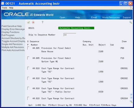

PBD AAIs provide for the accrual of unrecorded costs for the base house or one of three option types. You enter the account for the credit entry in the Provision Liability processing option for the Provision for Final Cost program as well as the lot business unit, object, and subsidiary range in the Data Selection.
The following is an example of PBD AAIs.
Figure 53-5 Automatic Accounting Instructions (Provisional Based Debit) screen

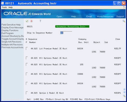

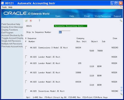

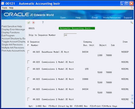

You use Model Journal Entries in booking the revenue. The model journal entries include entries for base house, commissions, cash, design center, lot, and option.
The following are examples of the AAIs for the model journal entries.
Figure 53-6 Automatic Accounting Instructions (Bathhouse Model) screen

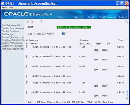

Figure 53-7 Automatic Accounting Instructions (Commissions 2 Model) screen
Figure 53-8 Automatic Accounting Instructions (Commissions 3 Model) screen
Figure 53-9 Automatic Accounting Instructions (Lot Premium Model) screen
