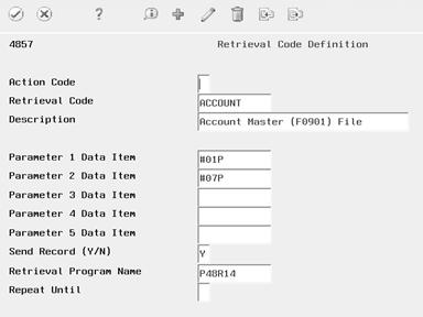

To define custom retrieval codes
On Retrieval Code Definition
Figure 6-1 Retrieval Code Definition screen
Complete the following fields:
Retrieval Code
Description
Parameter 1 Data Item
Retrieval Program Name
Complete the following optional fields:
Parameter 2 Data Item - Parameter 5 Data Item
Send Record (Y/N)
Repeat Until
| Field | Explanation |
| Parameter 1 Data Item (P1DI) | You must specify a Data Item name if the parameter is used by the specified retrieval code. The Data Item controls the glossary and editing for the parameter at the time the Retrieval Code is being referenced. |
| Send Record (Y/N) | A Retrieval Code is generally processed in conjunction with an individual Billing Workfile record. Specific Retrieval Codes can require access to all of the information contained on the workfile record. You can use the Send Record code to instruct the system to include the entire workfile record, in one data structure, as one of the parameters passed to the Retrieval Program.
You can use this field to determine which parameters from the Billing Workfile (F4812) will be passed to the Retrieval Program. The values are: Y – Yes, send the entire Billing Workfile. N – No, send only the specified parameters. |
| Retrieval Program Name | The Retrieval Program is the name of the program that will be executed to extract the desired data and return a value. The Retrieval Program must exist as a valid program in the user's library list by the time it is called. The program must conform to the common interface standards used by the system and must accept the correct number and type of parameters. |
| Repeat Until | You can use this code to control information that the system retrieves in a repetitive manner, such as lines of text within a text file. The Invoice Print program continues to use the same Retrieval Code in the same position until the specified condition is achieved. The following values are valid:
blank – No repetition. Stop after the first line of text. C – Conflict. Repeat the Retrieval Code in the same position on subsequent lines until a line is reached that contains information in the same positions that the Retrieval Code would use or until the end of the format is reached. You might use this code if you were using a pre-printed form with a restricted number of lines for the information. D – Done. Repeat the Retrieval Code and the associated format line until the Retrieval Program returns an "end of file" value. Note: You must assign the same number of characters per line to the retrieval reference code as the retrieved information requires. The text will not wrap. Each line will be truncated when the characters per line is reached. |
