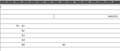

The Format Definition form displays 70 positions horizontally. You can place the cursor anywhere in the existing form display. If you need to place your cursor outside the form display, you must enter a number in the Window Increment field and choose the Window Right function (F20).
If you choose Window Right without entering a value in the Window Increment field, the system automatically enters 70 in the Window Increment field, and the cursor moves to the 70th position on the form display. To return, choose the Window Left function (F19).
The Format Definitions form includes a ruler that you can use to reference the position of the cursor within a line. The ruler consists of dots, asterisks, and numbers. Each symbol represents the following space increment:
| Symbol | Spaces |
| Dot | 1 space |
| Asterisk | 5 spaces |
| Number | 10 spaces |
Use the ruler to find an exact position on the Format Definition form. For example, to place your cursor in the 37th position on a line, you use the ruler to move the cursor to the number 3 position, plus the following asterisk, plus two dots.
In the following graphic, the retrieval reference (&1) is at position 20 and the cursor is at position 37:
Figure 5-1 Layout Definition Ruler Detail

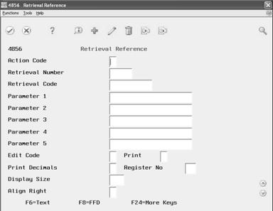

To define retrieval references for a format
On Invoice Layout Revisions
Complete the steps to locate the format definition for a layout structure or data item.
On Format Definition, position your cursor where you want the retrieved information to print.
Choose Retrieval Reference (F13).
On Retrieval Reference, choose Field Sensitive Help (F1) for the following field to see a list of the predefined retrieval codes:
Retrieval Code
Figure 5-3 Retrieval Code Selection screen
On Retrieval Code Selection, choose the code you want to use to define the retrieval reference (Option 4).
On Retrieval Reference, complete the following fields to specify any of the parameters required for the retrieval code:
Parameter 1-5
If the retrieval code specifies a table, position your cursor in Parameter 1 and choose File Field Description (F8) to determine the correct data item.
Complete the following field:
Display Size
You must complete the Display Size field. If you do not specify a display size, the reference will not retrieve the related information.
To specify a register in which to store the retrieved information, complete the following field:
Register Number
To control the format specifications for the retrieved information, complete the following fields:
Edit Code
Print Decimals
Align Right
Use the Add action.
The system clears the window.
Choose Exit Program (F3).
The system closes the Retrieval Reference window and displays an ampersand (&.) and the number of the retrieval reference (without leading zeros) in the line and position where you last located the cursor.
