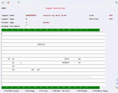

Choose any of the following functions to review a specific format definition form for the layout structure:
Header Format Definition (F13)
Alternate Header Format Definition (F14)
Total Format Definition (F15)

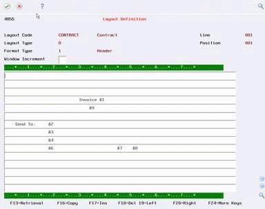

The following example shows the Format Definition form for the header of the layout structure.
Contract Billing
Figure 4-1 Layout Definition screen (contract)
Service Billing
Figure 4-2 Layout Definition screen (workorder)

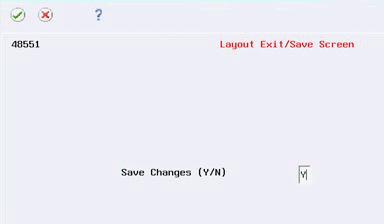

Choose Exit Program to return to Invoice Layout Revisions.
The system displays a message prompting you to save any changes you made to the Format Definition form.
Figure 4-3 Save Changes to Format Definition screen
Complete the following field:
Save Changes (Y/N)

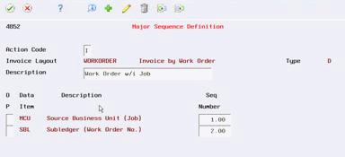

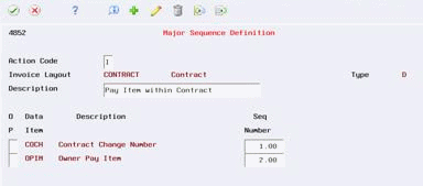

On Invoice Layout Revisions, choose Major Sequence (F17).
Contract Billing
Figure 4-4 Major Sequence Definition screen (contract)
Service Billing
Figure 4-5 Major Sequence Definition screen (workorder)

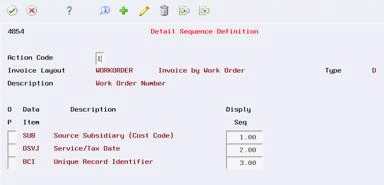

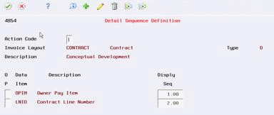

On Invoice Layout Revisions, choose Detail Sequence Definition (Option 4).
Contract Billing
Figure 4-6 Detail Sequence Definition screen (contract)
Service Billing
Figure 4-7 Detail Sequence Definition screen (workorder)
On Detail Sequence Definition, choose any of the following options to review a specific Format Definition form for a data item related to a grouping key range:
Header (Option 1)
Total (Option 3)
Complete steps 4 and 5 to return to Invoice Layout Revisions.

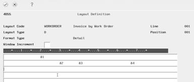

Detail Detail Format (Option 6)
Detail Total Format (Option 7)

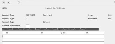

The following example shows the Format Definition form for the Detail Detail Format option for a grouping key range.
Contract Billing
Figure 4-8 Layout Definition screen (contract)
Service Billing
Figure 4-9 Layout Definition screen (workorder)

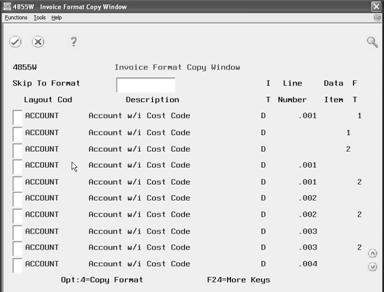

You can use the Invoice Format Copy Window (P4855W) to locate the specific format definition forms that you want to review or copy. The Invoice Format Copy Window displays a list of the all the formats defined in your system. The list is arranged alphabetically by the format code. You can identify each of the format types that are associated with a layout structure by using a combination of the following information:
Line numbers associated with specific grouping key ranges
Data item names associated with either a major or detail sequence
Format types, such as detail, header, or total, identified by the respective Format Type codes of blank, 1, or 2
When you use the Invoice Format Copy Window to identify a specific Format Definition form, consider the following questions:
What is the format code?
What is the invoice type?
What is the format type (header, total, detail)?
Is the format related to a data item or a grouping key?
If the format is related to a data item, is the data item related to a grouping key detail sequence or a major sequence?
If the format is related to a grouping key, which grouping key line?
The Invoice Format Copy Window does not display alternate header format definitions.
| Caution:Copying a format immediately updates and saves the new information in the Format Definition form. When you copy a format definition to another format definition form, the system replaces any invariable information, codes, and definitions for the retrieval references that are already in the Format Definition form with the invariable information, codes, and definitions from the format you selected to copy. You cannot retrieve the original information that was on the format. Exiting the program and entering N in the Save Changes (Y/N) field has no effect on the changes that you make to a Format Definition form by copying. |
Complete the steps for locating a layout structure.
On Format Definition, choose the Copy function (F16).
The system displays Invoice Format Copy Window.
Figure 4-10 Invoice Format Copy Window screen
To locate the format code you want to copy, complete the following optional field:
Skip To Format
Choose Copy Format (Option 4) for the format code.
The system copies the format information, including all related invariable information, retrieval reference codes, and code definitions, to the Format Definition form currently displayed. The copied format replaces any existing invariable information, codes, and code definitions that you previously defined on the Format Definition form.
