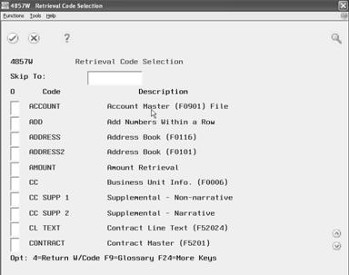

Choose Detail Sequence (Option 4) for the first grouping key range.
For best results, define a detail sequence for each grouping key range of transactions that you want to print on the invoice.
Contract Billing
Service Billing
Figure 3-8 Retrieval Code Selection screen
On Detail Sequence Definition, choose Display All Data Items (F16).
Complete the following field for the data items you want to include in the sequence:
Display Sequence
Use the Add action.
The system clears the form.
Choose Exit Program (F3).

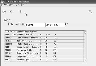

To add invoice format data items
On Invoice Layout Data Items
Figure 3-9 File Field Descriptions screen
Locate a blank line.
| Caution:Do not type over existing data items on the Invoice Layout Data Items form. Typing over an existing data item deletes it from the Available Data Items table and can cause unpredictable results. |
Complete the following fields:
Data Item
Description
Complete the following optional field:
Sequence Number

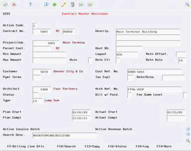

From the Contract Billing Processing menu (G52), choose Contract Master Revisions (P5201).
If you use the Contract Billing system, you can assign an invoice format code for a specific layout directly to your contracts without assigning layouts globally. The layout you assign directly to a contract overrides any cross-reference information you set up on the Format Cross Reference form (P4858).
To assign invoice format codes to contracts
On Contract Master Revisions
To locate a contract master, complete the following field:
Contract Number
Choose Field Sensitive Help (F1) for the following field:
Layout
On Invoice Format Selection, choose Return with Value for the invoice format code of the layout you want to assign to the contract.
On Contract Master Revisions, use the Change action.

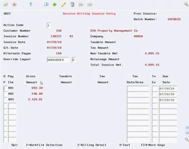

You can assign invoice format codes for a layout to individual invoices that you generate using the Service Billing system. When you assign an invoice format code directly to an invoice, you override any cross-reference information you set up on the Format Cross Reference form (P4858).
For example, you might find that one of the invoices in a batch of invoices should be printed using a different layout than is specified on the Format Cross Reference form. You can enter an override invoice format code on the invoice and print the invoices. Then, if you need to, you can change the cross-reference information you have set up for your system at a later time.
Create an invoice batch. See Generating Invoices for Billing or Creating Invoices Manually for Billing in the JD Edwards World Service Billing Guide for more information about creating a batch of invoices.
To assign invoice format codes to invoices
On Batch Review
To locate the invoice batch, complete the following field and press Enter:
User ID
Choose Detailed Batch Review (Option 1).
On Invoice Entry Review (P48222), choose Review Invoices (Option 1).
On Service Billing Invoice Entry (P4822), choose Field Sensitive Help (F1) for the following field:
Override Format
On Invoice Format Selection, choose Return W/Value for the invoice format code of the layout you want to use.
On Service Billing Invoice Entry, use the Change action.
After you enter the information, the system returns to Service Billing Invoice Entry and displays the code name and type in the Override Format fields.
Figure 3-12 Service Billings Invoice Entry screen
