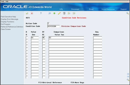

You use the Condition Code Revisions form to set up and revise the codes that you apply to your reallocation rules. These codes define the conditions that transactions must meet before the system can create the resulting journal entries specified by the account derivation rules.
When you use condition codes, the system requires additional processing time to test each condition before creating the resulting journal entries.
You use logical operators, retrieval references, and specific values to define the conditions that make up a condition code. Logical operators include and, or, equal, not equal, and so on. Retrieval references direct the system to specific variable information stored in system tables, such as data items. If you set up a condition code with multiple conditions, you use an and/or statement.
For example, you might define a condition as "Business Unit equal to 5001." Equal is the logical operator. The retrieval reference directs the system to the data dictionary item for Business Unit. Finally, 5001 is a specific value that refers the system to a specific business unit in the system. If you assigned a condition code that included this condition to a reallocation rule, the rule would only apply to transactions that included Business Unit 5001 in the account information.

Choose Condition Code Definition (F13).
Figure 21-2 Condition Code Definition screen
On Condition Code Revisions (P4871), complete the following field to locate a condition code:
Condition Code
Complete the following field to define more than one condition for the code:
And/Or Selection (AO)
Complete the following fields to define the conditions:
Value One
Relationship (Df Rl)
Comparison Value Two
Sequence Number (optional)
