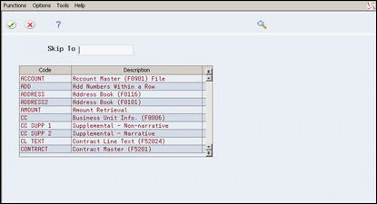

  3. On Retrieval Reference, choose Field Sensitive Help (F1) for the following field to see a list of the predefined retrieval codes:
    • Retrieval Code
    Figure 22-2 Retrieval Code Selection screen
    Description of Figure 22-2 follows
    Description of ''Figure 22-2 Retrieval Code Selection screen''
  4. On Retrieval Code Selection, choose the code you want to use to define the retrieval reference.
