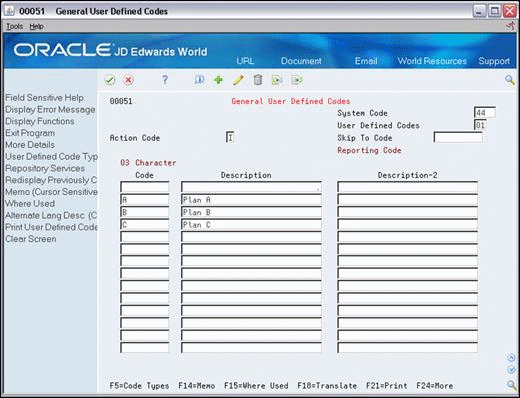

Complete the following fields to locate table 44/01:
System Code
User Defined Codes
Figure 28-2 General User Defined Codes screen, Search Results for Table 44/01
Enter the plan codes.

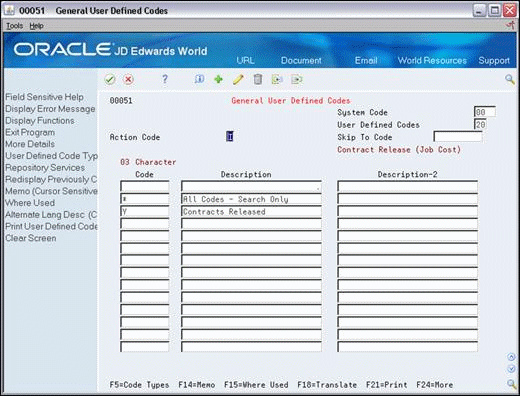

You must set up codes to indicate from which job plan to release commitment distribution details when you make progress payments.
On any User Defined Code Revisions screen, complete the following fields to locate table 00/20:
System Code
User Defined Codes
Figure 28-3 General User Defined Codes screen, Search Results for Table 00/20
Enter the contract release codes.

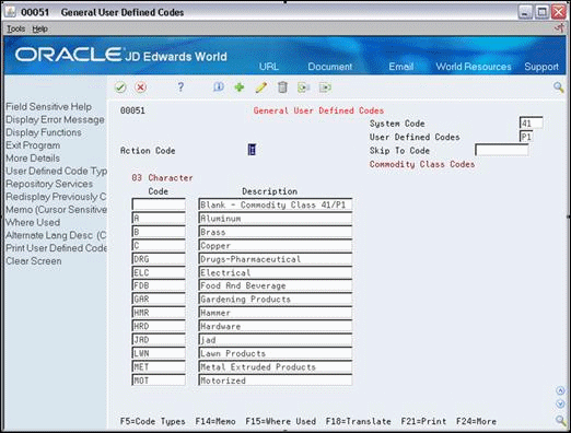

You must define each type of subcontractor that you use to perform the work. For example, you might enter code ELE for electrical subcontractors and code PLB for plumbing subcontractors.
On any User Defined Code Revisions screen, complete the following fields to locate table 41/P1:
System Code
User Defined Codes
Figure 28-4 General User Defined Codes screen, Search Results for Table 41/P1.
Enter your supplier category codes.

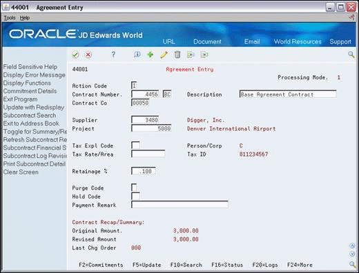

You must enter identifying information for each base agreement. Identifying information includes details about the contract company, subcontractor information, and financial details such as tax rates and retainage.
To enter identifying information
On Agreement Entry, enter the base agreement code in the following field:
Contract Type
Complete the following fields:
Contract Company
Supplier
Complete the following optional fields:
Project
Tax Explanation Code
Tax Rate/Area
Retainage %
Complete the following field with the appropriate preferred supplier code:
Hold Code
| Field | Explanation |
| Hold Code | A user defined code (system 42, type HC) that indicates why an order was put on hold. Any value other than the default of blank will cause all vouchers entered against the contract to have a pay status of H and be automatically bypassed during Accounts Payable check processing. Screen-specific information A processing option specifies whether you can modify this field. If you are setting up a base agreement, you should enter the appropriate preferred supplier code in this field. |

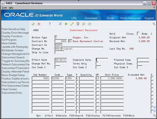

After you enter identifying information for the base agreement, you must enter the commitment details for each job plan. When you enter commitment information for your base agreements, you must use only cost codes and cost types that are valid for all contracts.
On Agreement Entry, complete the following fields to locate the contract:
Contract Number
Contract Type
Choose Commitment Details (F2).
On Commitment Revisions, complete the following fields:
Effective Date
Job
Code
Type
You must enter the project number from the Job Master Revisions screen in the Job field.
Complete the following field with the supplier category code:
Cat Code 1
Choose More Details (F4) to access the detail area.
Figure 28-7 Commitment Revisions screen, Detail area

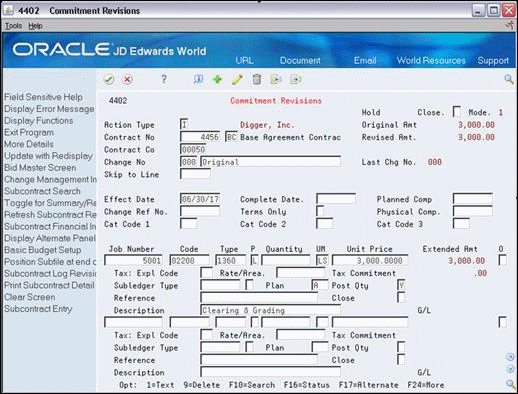

Complete the following required field for each plan:
Plan
Complete the appropriate fields for each plan:
Pricing Type
Units
Unit of Measure
Unit Price
Rate/Area
Subledger
Subledger Type
Post Quantity
| Plan | This user defined code is for log entry reporting purposes. Screen-specific information Use this field for base agreement processing to specify a job category for the commitment line. |
