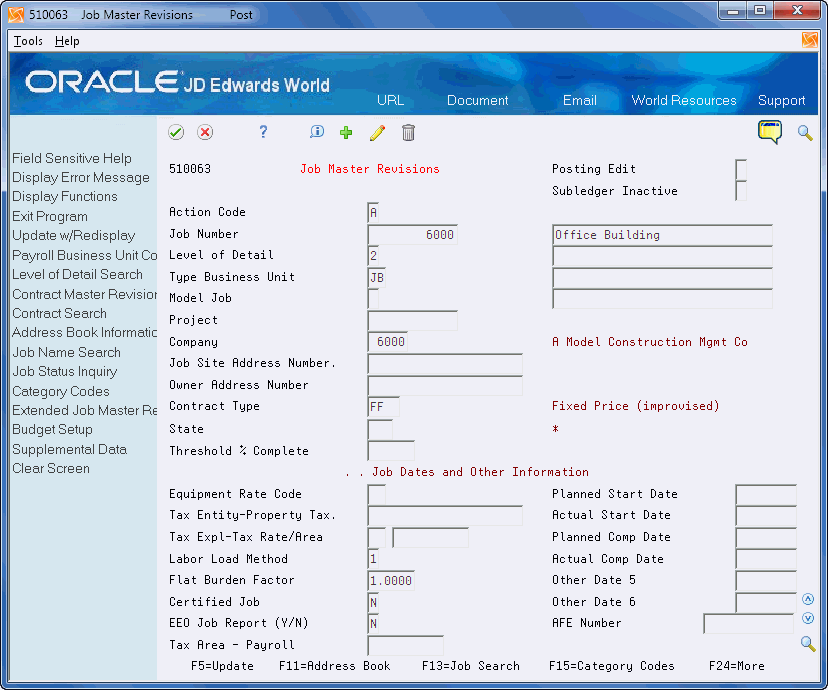

Before you use the Subcontract Management system, you create a job master record for each of your projects and jobs. A job master record includes basic identifying information about your projects and jobs.
On Job Master Revisions, complete the following fields for each of your Subcontract Management projects or jobs:
Job Number
Name
Company
Complete the following optional fields:
Type Business Unit
Level of Detail

After you create a job master record for a project, you must set up the jobs within the project. For example, if your project is an office building, you might set up each floor of the building as a separate job.
Assume that you set up job number 6000 for the office building project. You should set up floor 1 as job 6001, floor 2 as job 6002, floor 3 as job 6003, and so on.
To set up jobs within a project
On Job Master Revisions, complete the following fields:
Job Number
Name
Company
When you set up the jobs within a project, you must enter the job number of the project in the Project field for each job.
Type Business Unit
Level of Detail
Project

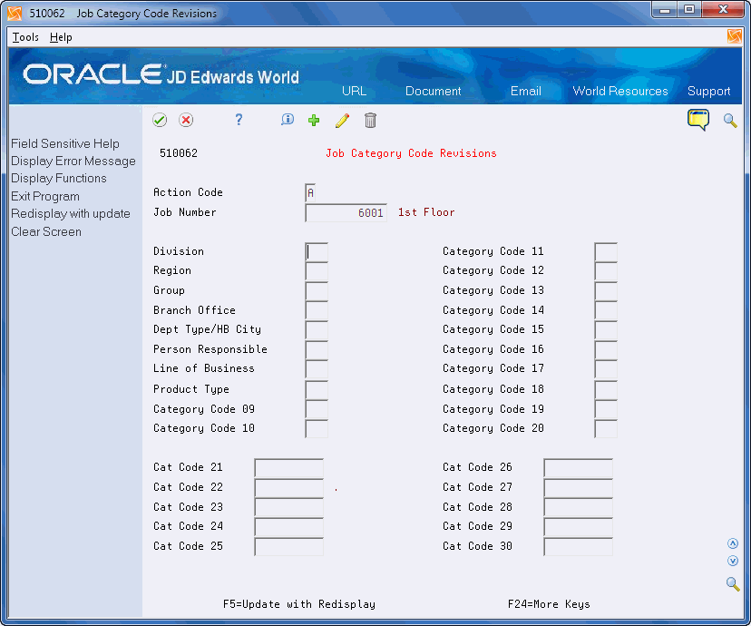

To set up a base agreement, choose Category Codes (F15).
Figure 3-3 Job Category Code Revisions screen
On Job Category Code Revisions, complete the following fields if you are setting up a base agreement:
Category Code 19
Category Code 20

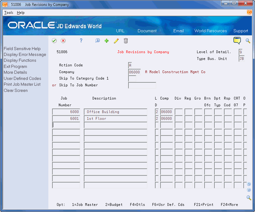

If you have multiple jobs within a company, you can set them up at the same time.
| See Also:
To set up jobs within a project, you must first create a job master record for the project.
To set up multiple jobs by company
On Job Revisions by Company, complete the following field:
Company
For each job, complete the following fields:
Job Number
Description
For each job, complete the following optional field:
Level of Detail

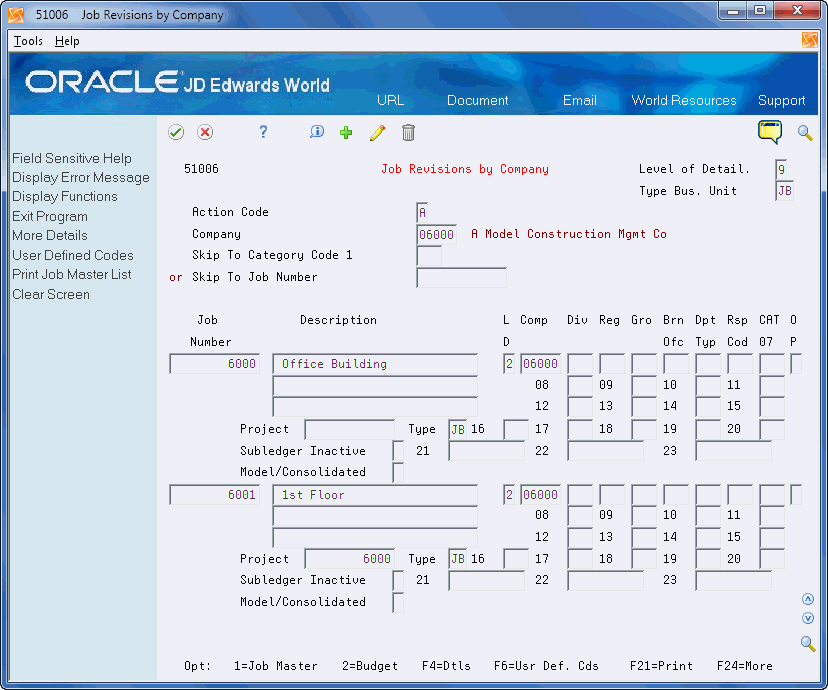

Figure 3-4 Job Revisions by Company screen
Choose More Details (F4) to access the detail area.
Figure 3-5 Job Revisions by Company screen, Details area
For each job, complete the following field:
Project
Type
If you are setting up a base agreement, complete the following fields:
Category Code 19
Category Code 20
