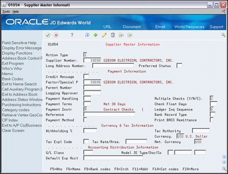

To set up subcontractor information for contract progress payments
On Supplier Master Information, to locate the subcontractor, complete the following field:
Supplier Number
Figure 42-2 Supplier Master Information screen
Enter M in the following field:
Payment Instrument
To enable the Accounts Payable system to create contract progress payments, enter C in the following field:
Multiple Checks

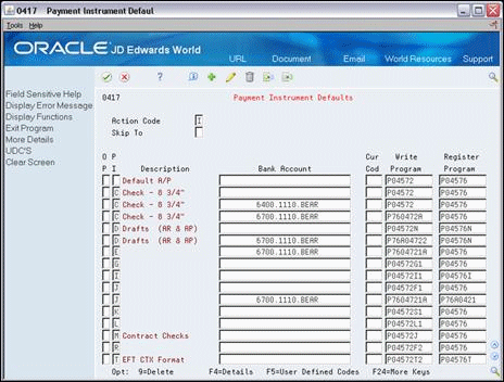

From Automatic Payment Processing (G043), enter 29
From Accounts Payable Setup (G0441), choose Automatic Payment Setup
From Automatic Payment Setup (G04411), choose Payment Instrument Defaults
To verify print options for payments
On Payment Instrument Defaults, verify that Write Program P04572J is in the Write Program field for the Contract Checks line.
Figure 42-3 Payment Instrument Defaults screen
