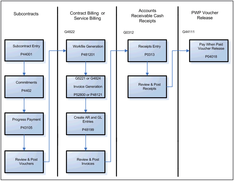

After you enter Pay When Paid data for a subcontract, the Pay When Paid process includes the following steps:
Create Pay When Paid vouchers for items with a W in the Pay Status field using the Progress Payment Entry program (P43105). Vouchers with a W in the Pay Status field indicate they are Pay When Paid vouchers. See Chapter 11, "Enter Vouchers".
Post the vouchers.
Select vouchers for the Billing Workfile table (F4812) in Contract Billing or Service Billing.
Create resulting Accounts Receivable invoices using Contract Billing or Service Billing.
Apply cash receipts to invoices in the Accounts Receivable system.
Use a batch process to update the pay status of vouchers that are eligible for payment using the Pay When Paid Voucher Release program.
Use the Accounts Payable Payment Processing to pay eligible vouchers.

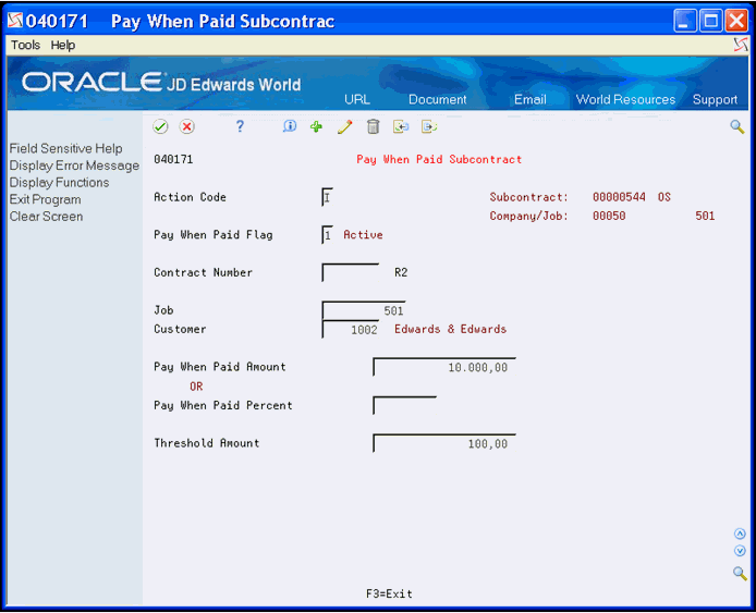

After you add or locate an existing contract on Subcontract Entry, you can enter Pay When Paid information in the Pay When Paid Subcontract Defaults program (P040171). The system stores this information in the Subcontract Pay When Paid Defaults table (F04017).
If you set the Display Number of Jobs processing option for the Contract Entry program (P44001) to 2, the Pay When Paid screen automatically displays when you add a subcontract. If you activate multi-currency, the Currency Code field displays at the bottom of the Pay When Paid Subcontract screen.
To set up pay when paid subcontract defaults
On Subcontract Entry, choose Pay When Paid Subcontract (F8).
On Pay When Paid Subcontract, complete the Pay When Paid Flag field.
Figure 30-3 Pay When Paid Subcontractor screen
Perform one of the following:
Complete the Contract Number field.
Complete the following fields:
Job
Customer
Pay When Paid Amount
Pay When Paid Percent
Complete the following optional field and click Add.
Threshold Amount
| Field | Explanation |
| Pay When Paid Flag | A value that indicates the status of a Pay When Paid Subcontract. Valid values are: ' ' - Inactive: Vouchers for the subcontract are not tracked through Contract Billing or Service Billing. '1' - Active: Vouchers for the subcontract are tracked through Contract Billing or Service Billing, where invoices are created, to Accounts Receivable, where the invoice payments are monitored until the vouchers can be released. '2' - Complete: Invoice payments met or exceeded the Pay When Paid amount or percent for the subcontract. The vouchers have been released. |
| Pay When Paid Amount | The amount that must be received from the customer for payment of invoices that include the subcontract Pay When Paid vouchers. When this amount is reached, all Pay When Paid vouchers for the subcontract will be released. Screen-specific information The system uses the gross invoice and receipt amounts to determine if it can release the vouchers. |
| Pay When Paid Percent | The percentage of the subcontract amount that must be received from the customer for payment of invoices that include the subcontract Pay When Paid vouchers. When this percentage is reached, all Pay When Paid vouchers for the subcontract will be released. Enter percentages as whole numbers. For example, 50.275% would be entered as 50.275. Screen-specific information The system calculates the release amount by totaling all amounts in the Amount - Extended Price field (AEXP) for the subcontract (original amounts and any revisions) multiplied by the Pay When Paid Percent. |
| Threshold Amount | Subcontract voucher pay items that meet or exceed this amount are eligible for Pay When Paid processing. The pay item is created with Pay Status W (Held - Pay When Paid). When the voucher amount is below the subcontract threshold amount, or if the pay item is related to a non-billable expense account, then the voucher is not included in Pay When Paid processing. |

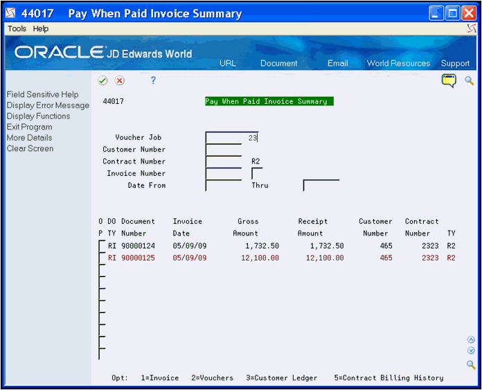

From Pay When Paid Operations (G44111), choose Pay When Paid Invoice Summary
The Pay When Paid Invoice Summary program (P44017) allows you to review Pay When Paid Invoices and the information you associate with them. The program retrieves information from the Customer Invoice Summary-Pay when Paid (F03017) table.
To review pay when paid invoices
On Pay When Paid Invoice Summary, complete the Voucher Job field.
Figure 30-4 Pay When Paid Invoices Summary screen
To narrow your search, complete the following fields:
Customer Number
Contract Number
Invoice Number
Date From
Thru
Choose More Details (F4) to access multi-currency and other information.
Enter one of the following in the Option field to review additional information:
1 - To access the A/R Invoice Entry program (P03105) to review more detail about the invoice record.
2 - To access the Pay When Paid Vouchers program (P04019) to review more detail about the voucher record.
3 - To access the Customer Ledger Inquiry program (P032002) to review more detail about the Customer.
5 - To access the Contract Billing History Inquiry program (P52250) to review more detail about the invoices associated with a Contract Billing contract.
