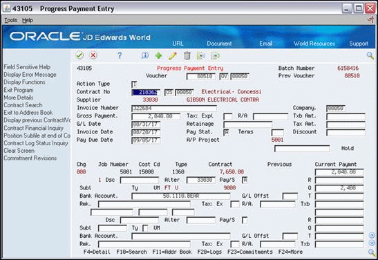

To enter a voucher with amounts
On Progress Payment Entry, complete the following field and click Add.
Contract Number
Figure 11-1 Progress Payment Entry screen
Complete the following fields:
Invoice Number
Company
G/L Date
Current Payment
Complete the following optional fields:
Gross Payment
Pay Due Date
Figure 11-2 Progress Payment Entry screen, Optional fields
After you enter a voucher, the system displays the voucher number in the Previous Voucher field on Progress Payment Entry. You should note the voucher number for future reference.

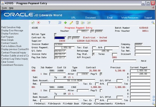

You can enter a voucher withholding a portion of the gross payment as retainage. Retainage is a percentage of the committed amount that is held until a specific date after the completion of the contract. For example, if you enter a voucher for 100 with retainage of 10 percent, the actual payment will be 90, with 10 held as retainage.
You can enter a voucher with retainage which you apply to the entire voucher, or you can apply retainage by line item of the voucher.
Use the VAT on Retainage processing option to defer VAT tax on retainage. When you set this processing option and you use a tax type of C or V, the system creates a third record to the Accounts Payable Ledger table (F0411) that is a tax record only. When you release retainage, the system reclassifies the deferred VAT to VAT recoverable.
| Topic | Description |
| Selecting processing options | Set the Default Retainage from the Contract processing option to allow the system to enter the retainage amount as a percentage from the contract. |
| VAT tax with retainage | If you set the Vat on Retention processing option to 1 and you use a tax type of C or V, the system calculates amounts differently. It subtracts retainage from the original taxable amount and recalculates new amounts. |
To enter a voucher with retainage
Contract Number
Invoice Number
Company
G/L Date
To enter retainage for the entire voucher, complete the following field:
Retainage
Choose More Details (F4) to access the detail area.
If you enter a monetary amount in the Retainage field, complete the following field to enter retainage for individual line items:
R
Figure 11-4 Progress Payment Entry screen, Detail area
The sum of the amounts in the R fields must equal the amount in the Retainage field.
