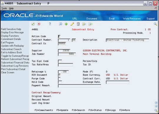

To enter identifying information
From Subcontract Management (G44), choose Daily Operations
From Subcontract Management Daily Operations (G4411), choose Subcontract Entry
On Subcontract Entry, complete the following fields:
Contract Company
Supplier
Complete one of the following fields:
Project
Job
Complete the following optional fields:
Description
Tax Explanation Code
Tax Rate/Area
Retainage
Hold Code
| Field | Explanation |
| Contract Co | A number that, along with order number and order type, uniquely identifies an order document (such as a purchase order, a contract, a sales order, and so on). If you use the Next Numbers by Company/Fiscal Year facility, the Automatic Next Numbers program (X0010) uses the order company to retrieve the correct next number for that company. If two or more order documents have the same order number and order type, the order company lets you locate the desired document. If you use the regular Next Numbers facility, the order company is not used to assign a next number. In this case, you probably would not use the order company to locate the document. Screen-specific information If you leave this field blank, the system supplies the company assigned to the project or job. If you do not enter a project or job number you must enter the contract company number. |
| Supplier | A number that identifies an entry in the Address Book system. Use this number to identify employees, applicants, participants, customers, suppliers, tenants, and any other Address Book members. Screen-specific information Enter the address book number of the subcontractor for the contract. |
| Project | A code that identifies a separate entity within a business for which you want to track items and costs. This entity might be a warehouse location, job, project, work center, or branch/plant. The Business Unit field is alphanumeric. Screen-specific information A processing option specifies whether this field appears on the screen and if so, what its title is (Job Number or Project).
| Tax Expl Code | A user defined code (00/EX) that controls how a tax is assessed and distributed to the general ledger revenue and expense accounts. You assign this code to a customer or supplier to set up a default code for their transactions. Do not confuse this with the taxable, non-taxable code. A single invoice can have both taxable and non-taxable items. The entire invoice, however, must have one tax explanation code. Screen-specific information If you leave this field blank, the system supplies the code assigned to the project or job. If no code is assigned to the project or job, the system supplies the code from the Supplier Master table. |
| Tax Rate/Area | A code that identifies a tax or geographic area that has common tax rates and tax distribution. The tax rate/area must be defined to include the tax authorities (for example, state, county, city, rapid transit district, or province), and their rates. To be valid, a code must be set up in the Tax Rate/Area table (F4008). Typically, U.S. sales and use taxes require multiple tax authorities per tax rate/area, whereas VAT requires only one simple rate. The system uses this code to properly calculate the tax amount. Screen-specific information Use this field to override the value entered for the contract in the Tax Expl Code field on the Contract Entry screen. The value in this field is for the particular commitment distribution item only. |
| Retainage % | The rate of retainage (referred to as "holdback" in some countries) that applies to the contract. This rate is a percentage of each payment. It is expressed as a decimal fraction. For example, retention of 10% is expressed as .10. The retainage rate cannot be greater than 99.9% (.999) or less than zero. Screen-specific information You can override the rate entered on this screen with another rate or amount on the Progress Payment Entry screen. |
| Hold Code | A user defined code (system 42, type HC) that indicates why an order was put on hold. Any value other than the default of blank will cause all vouchers entered against the contract to have a pay status of H and be automatically bypassed during Accounts Payable check processing. Screen-specific information A processing option specifies whether you can modify this field. If you are setting up a base agreement, you should enter the appropriate preferred supplier code in this field. |
