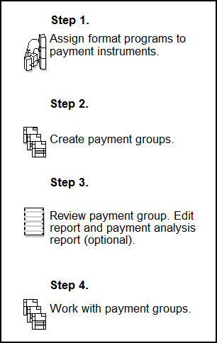

You use automatic payment processing to pay vouchers during your usual payment cycle. To process automatic payments, you assign formats to payment instruments. Then you create payment groups. After you create your payment groups, you process automatic payments in the group. When you select the Write function for your payment group, the system determines which payment formats to generate based on the payment formatting programs that you assign to your payment instruments.
Working with automatic payments includes the following tasks:
Assigning formats to payment instruments
Creating a payment group
Working with payment groups for automatic payments
The following illustrates working with automatic payments.

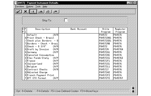

To assign formats to payment instruments
On Payment Instrument Defaults
Figure 23-2 Payment Instrument Defaults screen
Complete the following fields:
Payment Instrument
Write Program
Register Program
Complete the following optional field:
Bank Account
Choose the Details function.
Attachment Program
Debit Statement Program
To specify a particular version for a format program, complete the following fields:
Write Version
Register Version
Debit Statement Version
Attachment Version
