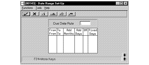

To set up a date range as part of your due date rule, choose the Date Range option next to the rule.
On Date Range Setup, complete the following fields:
From Day Range
To Day Range
Complete the following optional fields and press Enter:
Add Months
Add Days
Fixed Days
Choose the Update function to update and redisplay the due date rule.

| From Day | This field indicates the lower value of a day range. The allowable values are 1 to 31. This must be lower than the To Day value. |
| To Day | This field indicates the upper value of a day range. The allowable values are 1 to 31. This must be greater than the From Day value. |

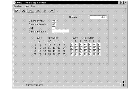

On Work Day Calendar
Complete the following fields:
Branch
Calendar Year
Calendar Month
The calendar for the month and year displays twice. The left portion of the screen shows the numerical days, and the right portion of the screen shows the work days and non-work days.
In the right portion of the screen, change the default values as necessary for each day of the week.
| Option | Explanation |
| Specifying the type of day | Some examples of the type of day you can specify on the calendar are as follows:
| The Work Day Calendar program (P00071) | The Work Day Calendar program is a Manufacturing system program. On the Work Day Calendar screen, the Branch field refers to a Branch/Plant (business unit). Instead, it refers to the name that you assign to the work day calendar for your due date rules.
Therefore, when you set up a work day calendar, the system accesses it from the Work Day Calendar file (F0007), not the Business Unit File (F0006). |

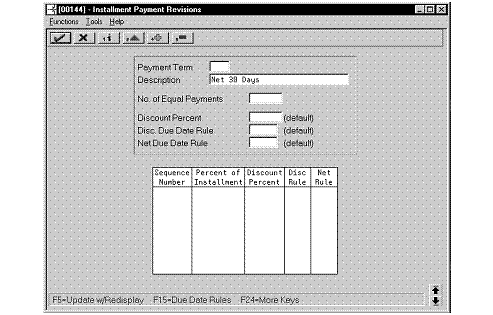

To set up installment payments
On Installment Payment Revisions
Figure 22-5 Installment Payment Revisions screen
Payment Terms
Description (optional)
To set up equal installment payments with the same due date rules, complete the following fields in the header area:
Number of Equal Payments
Discount Percent
Discount Due Date Rule
Net Due Date Rule
To set up unequal installment payments or to apply different due date rules, complete the following fields for each installment in the detail area:
Sequence Number
Percent of Installment
Discount Percent
Net Due Date Rule
| Field | Explanation |
| No. of Equal Payments | This field indicates the number of equal installments to be initially generated by the system. Using default values, the system uses this fast path method to create equal installments. |
| Discount Percent | The default value for the percent of the total invoice that will be discounted if the invoice is paid within the discount period. This is entered as a decimal, for example, a 2% discount is .02. Note, this field is only available the first time that installments are entered for a payment term. It is the value which will initially be replicated for the generated installments. |
| Disc. Due Date Rule | The default value of the discount due date rule that the system uses when generating equal installments.
Note: This field is only available for use when first generating new equal installments for a payment term. |
| Net Due Date Rule | The default value for the Net Due Date rule when generating equal installments. Note, this field is only available for use when first generating new equal installments for a payment term. |
| Sequence Number | A number used to organize the file into a logical group for online viewing and reporting. |
| Percent of Installment | The percentage of the invoice that is going to be split to generate one installment. The total of all installments must add up to 100.00 % of the invoice total amount. This is different than the split payment concept where the split is a fixed percent. Here you create installments using variable percentages. If the percent of the installment is 20%, you enter it as 20. |
| Discount Percent | The percent of the total invoice that will be discounted if the invoice is paid within the discount period. This is entered as a decimal, for example, a 2% discount is .02. |

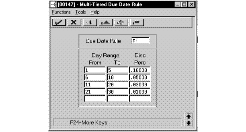

You can set up payment terms that allow for multiple discount percentages for invoices or vouchers. For example, you might set up a payment term that allows your customer to receive a 20 percent discount on their invoice if they remit payment within 10 days, a 10 percent discount if the invoice is paid within 20 days, and no discount with the full amount due in 30 days.
After you set up payment terms for multi-tiered discounts, you can assign the payment terms to the applicable vouchers or invoices. Then, you run the multi-tiered batch update program to recalculate the discount available and the due date for your vouchers or invoices. The system changes the discount percent based on the number of days that have passed and the current tier.
For example, you could put the Update A/R Invoice Batch program in your sleeper routine so that is runs nightly. Then, you can set up a multi-tiered payment term for which the first tier is 30 percent for 10 days and the second tier is 20 percent for 20 days. You assign the payment term to an invoice.
When the invoice is 11 days old and the multi-tiered batch update program is run, the system replaces the discount amount at 30 percent with the discount amount at 20 percent. The discount due date becomes 20 days from the date of the invoice. In the Accounts Payable system, the net due date is changed to 20 days from the date of the voucher.
Caution: Multi-tiered payment terms can be used only by companies that set the tax rule for calculating tax on gross (including discount) to "yes". Vouchers and invoices that are generated by companies with the tax rule for calculating tax on gross (including discount) set to "no" are not processed by the multi-tiered batch update programs because the programs cannot update the discount amount without changing the tax amounts. Unless the multi-tiered batch update programs process the documents, the vouchers and invoices do not move to the next tier and the due dates and discount percent remain the same unless manually changed. |
Verify that your company tax rules are set up correctly. See Tax Rules by Company (P0022) in the JD Edwards World Tax Reference Guide.
Set up or choose the net due date rule that you will use for your multi-tiered payment term.
Set up a payment term code for your multi-tiered payment term.
Working with payment terms for multi-tiered discounts consists of the following tasks:
Setting up a multi-tiered due date rule
Updating the discount available for multi-tiered terms

From Payment Terms Revisions (G00141), choose Due Date Rule Revisions
Set up multi-tiered due date rules for payment terms that allow multiple discount percentages.
To set up a multi-tiered due date rule
On Due Date Rule Revisions
Date Rule
Description
To define how the system calculates the due date, complete any of the following fields:
Based on Date
Months to Add
Days to Add
Fix Days to Use
To specify information about a work day calendar, complete the following fields:
Calendar
Work Day Rule
Choose the Add Multi-Tiered Information option
Figure 22-6 Multi-Tiered Due Date Rule screen
Day Range From
Day Range To
Discount Percent
| From Day | Enter the from day value for the first tier. This must be equal to 1 as it is the first tier. |
| To Day | Enter the day value for the end day of the first tier. This must be greater than the from day value for this tier. There must be no overlaps and no gaps. |
| Discount % - Payment Terms | The percent of the total invoice that will be discounted if the invoice is paid within the discount period specified by the first tier. This is entered as a decimal, for example, a 2% discount is .02. |
