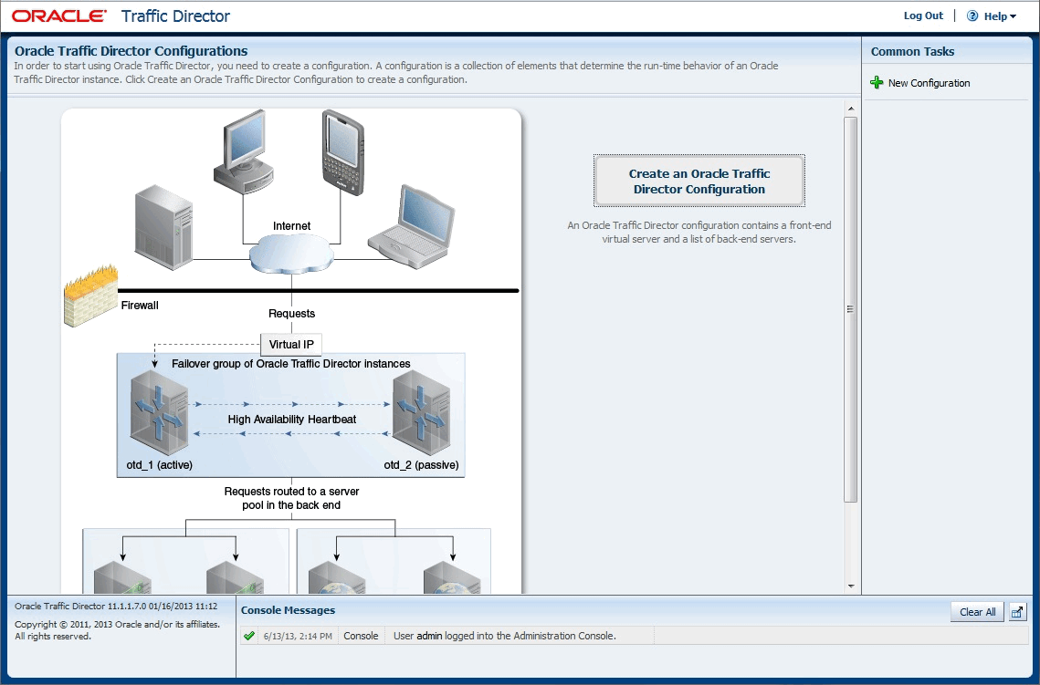

The administration console is a browser-based graphical interface that enables you create, configure, and monitor Oracle Traffic Director instances.
To access the Oracle Traffic Director administration console for an Oracle Java Cloud Service instance, follow the instructions to open the load balancer console in Accessing an Administration Console for Software that a Service Instance Is Running in Using Oracle Java Cloud Service.
When you complete this task, the home page of the administration-console is displayed.
Figure 2-1 Oracle Traffic Director Administration-Console Home Page
You can now administer the Oracle Traffic Director software for your Oracle Java Cloud Service instance.
If the administration-console browser session remains idle for 30 minutes, you will be logged out and the log-in page will be displayed.
