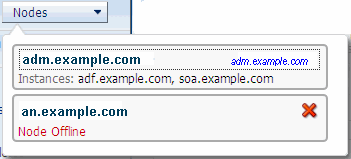

You can view a list of the administration nodes by using either the administration console or the CLI.
The CLI examples in this section are shown in shell mode (tadm>). For information about invoking the CLI shell, see Accessing the Command-Line Interface.
Viewing a List of Administration Nodes Using the Administration Console
To view a list of the available administration nodes by using the administration console, do the following:
To view the settings of an administration node in detail, click on the node.
To view a list of the administration nodes, run the list-nodes command, as shown in the following example:
tadm> list-nodes --verbose --all
node-name node-port node-online node-description
adm.example.com 8989 true "This is the Administration Server node"
an.example.com 8900 false -
