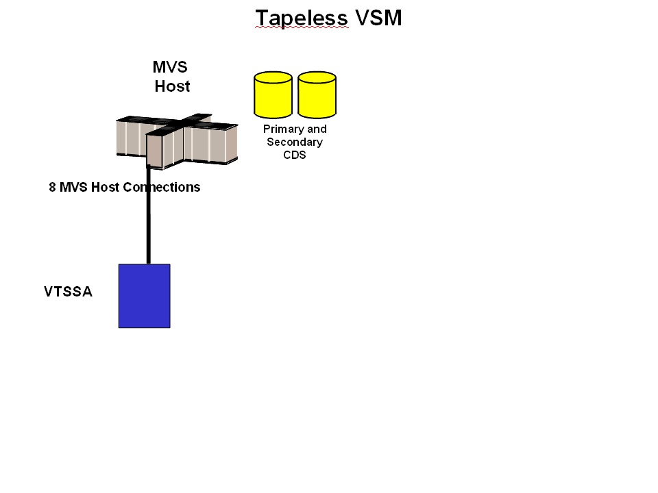

Figure L-1 shows a simple Tapeless VSM configuration where VTSSA has no RTDs attached.
Figure L-1 Tapeless VSM
Surrounding text describes Figure L-1 .
Configuring the System
To configure the example system shown in Figure L-1, code a CONFIG deck as shown in the following example.
In this example, note that there are no RTD statements for VTSSA because it is Tapeless.

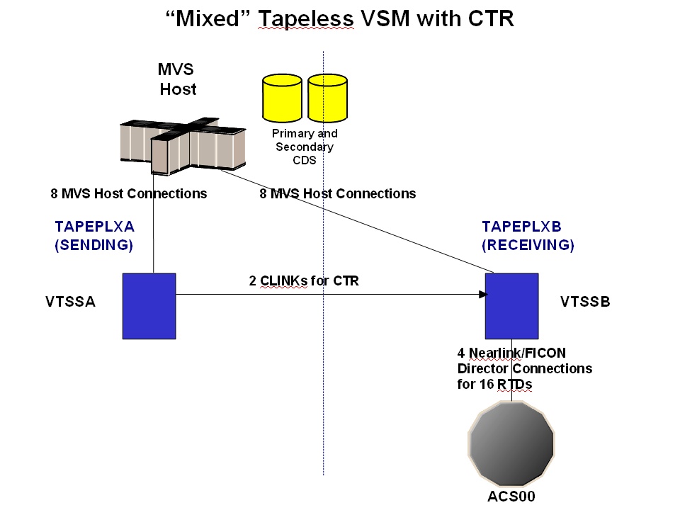

Figure L-2 shows two non-clustered VTSSs (VTSSA and VTSSB in separate TapePlexes) where VTSSA has no RTDs attached. VTSSA sends VTVs to VTSSB using CTR so that VTSSB can migrate the VTVs to tape in ACS00.
Figure L-2 Mixed Tapeless VSM
Surrounding text describes Figure L-2 .
As shown in Figure L-2, therefore, you can construct a "Tapeless" TapePlex, use CTR to connect this TapePlex to another TapePlex that has RTDs attached. With this configuration, you can make a "TapeLess" copy in the first TapePlex and replicate it to the second TapePlex where it can be migrated to tape. For more information on DTR, refer to the ELS Disaster Recovery and Offsite Data Management Guide.
