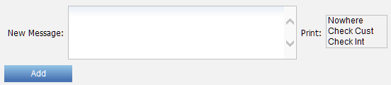

Review, change, and create order messages
Select Order Messages to advance to the Order Messages Window.

Entering new message lines
Optionally, use the upper part of the window to enter new order messages.
New message
Use this field to enter new free-form text messages. If your entry exceeds 60 positions and you do not press Enter to start a new line, the system splits the text into separate lines of up to 60 positions each, using the last occurring blank space before position 60 as a line break.
Print
Highlight the print option to the right of the New message field. Available options are:
• Check Cust = Print on refund check only
• Nowhere (default) = Do not print
• Check Int = Print on detachable area of refund check not visible to the customer
Click Add when you are done.
