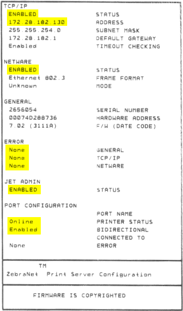

RF Printer Setup
Communicating with the RF Printer: The PRINTER_CONNECTION property in Working with Cloud Properties (CPRP) indicates how CWSerenade connects to the RF printer.
• TCP indicates CWSerenade connects to the RF printer using a TCP/IP socket connection.
• WIN indicates the RF printer is set up as a Windows Print Service. If you set up the RF printer as a Windows Print Service, you must perform some additional setup; see Setting Up the RF Printer Using Windows Print Service.
Regardless of how you set up the RF printer, you must complete the LabelPrinters Properties.
Important: If you print a high volume of labels at a time, MICROS recommends you set up the RF printer as a Windows Print Service.
If you change the PRINTER_CONNECTION setting: Check the label printer settings defined for each user on the Work with User Label Printers Screen and the associated system control values to make sure the label printer defined is a valid printer based on the printer connection setting.

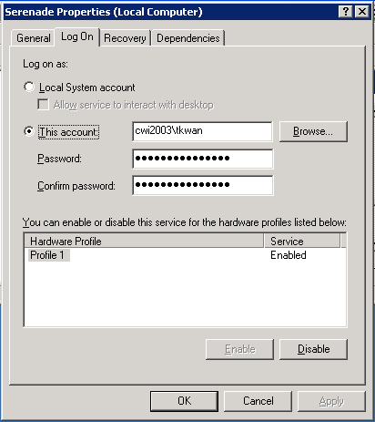

• The user account that installed CWSerenade; see below.

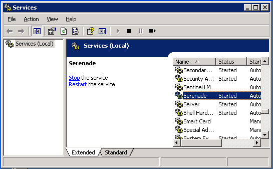

User account: In order for CWSerenade to recognize the printer, the user account that installed CWSerenade should be the same account that installs the Zebra Driver.
Note: If you have more than one CWSerenade application server, you must check the settings for each application server.
To determine the user account that installed CWSerenade:
1.
On the CWSerenade application server, select Start > Administrative Tools > Services to advance to the Services window.
2.
Locate the SERENADE service, right-click on the service, and select Properties to advance to the Serenade Properties window. Select the Log On tab to review the user account used to install CWSerenade. This is the user account you should use to install the Zebra Driver.

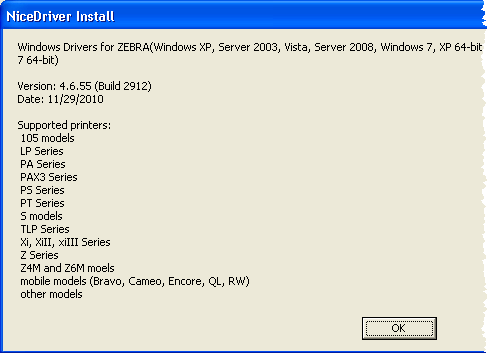

Installing the Zebra Print Driver
Install the Zebra Print Driver on a Windows network server. Note: In order to print labels correctly, do not install the Zebra Print Driver on a CWSerenade application server.
To install:
1.

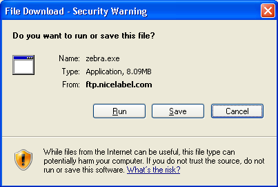

Download the Zebra Print Driver from the NiceLabel web site: http://www.nicelabel.com/downloads/nicedrivers/zebra. Refer to your Zebra printer documentation to determine the correct driver to download for your printer.

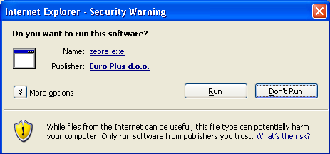

2.
When prompted to run or save the file, select Run.
3.
When prompted to run the software, select Run.
4.
Review the installation requirements, and select OK.

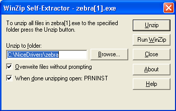

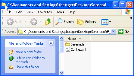

At the WinZip Self-Extractor window, select the location where you wish to extract the contents of the file, and select Unzip.
6.
When the files have all been extracted successfully, select OK.
7.
The installation wizard should start automatically. If it does not, locate the files that you have just extracted and double-click the install file (PrnInst.exe) to start the Installation Wizard.

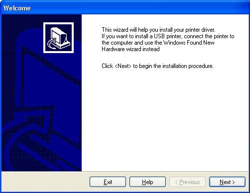

8.
At the Welcome window, click Next.

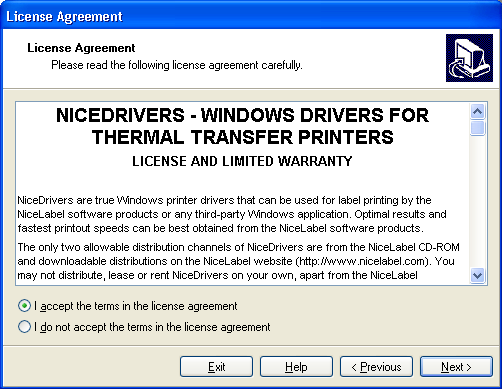

9.
At the License Agreement window, select I accept the terms in the license agreement and click Next.

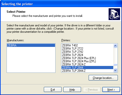

10.
At the Select Printer window, select the manufacturer and model of your printer. Click Next.

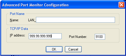

At the Printer Options window, select Add Port to advance to the Advanced Port Monitor Configuration window. Enter the IP address of your printer and click OK.
Printer name: The name of the printer should not contain any spaces.
Click Next.

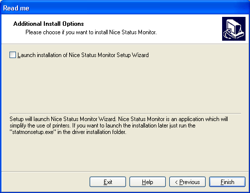

12.
At the Additional Install Options window, uncheck the additional installation options and click Finish to complete the installation.

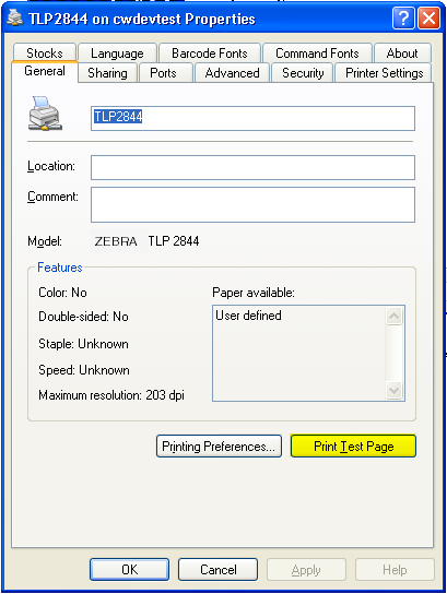

Sharing the Zebra Print Driver

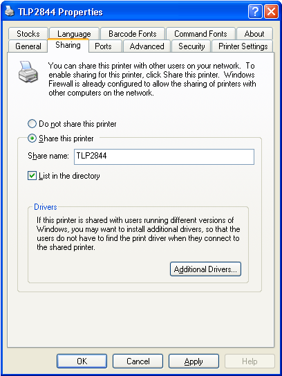

1.
On the server where you have installed the Zebra Print Driver, advance to Start > Printers & Faxes and locate the Zebra Print Driver you have just installed. Right-click on it and select Properties to advance to the Properties window.
On the Sharing tab: Select Share this printer, enter a Share name, and select List in the directory.
Click OK.

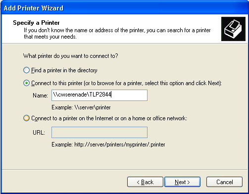

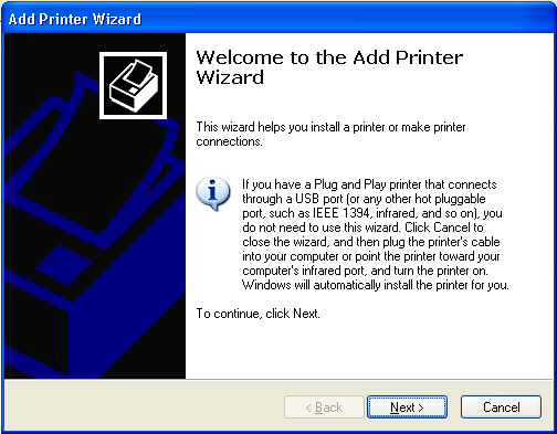

Adding the RF Printer to each CWSerenade Application Server
Complete these steps on each CWSerenade application server.

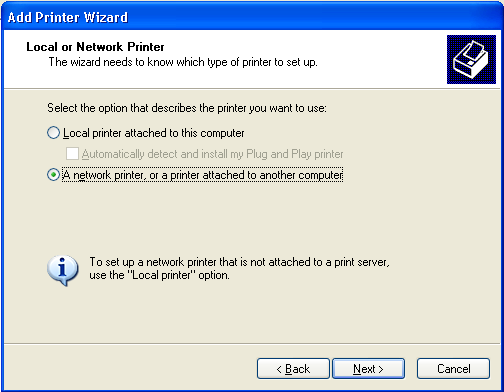

1.
Advance to Start > Printers & Faxes and select Add a printer to start the Add Printer Wizard.
2.
3.
At the Local or Network Printer window, select network printer. Click Next.
4.
At the Specify a Printer window, select Connect to this printer and enter the location of the Zebra Print Driver. Click Next.

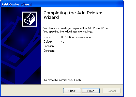

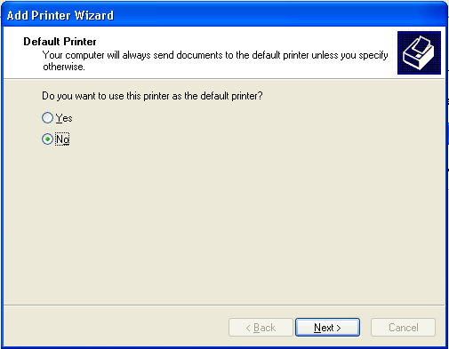

5.
At the Default Printer window, select No. Click Next.
6.
At the Completing the Wizard window, click Finish to complete the installation.
7.
In the Printers & Faxes window, right-click on the printer you just created and select Properties to advance to the Properties window. On the General tab, select Print Test Page to verify that the printer was installed correctly.

Verifying the RF Printer Configuration Settings
To check the configuration settings defined for the RF label printer:
1. Press the test button located on the back of the printer next to the power switch. To press the test button, you need to insert something small into the test button hole, such as a paperclip.
2. When you press the test button, the printer prints a configuration label. See Sample RF Configuration Label. Use this configuration label to:
• verify that the TCP/IP Status is ENABLED.
• verify that the IP address defined for the printer matches the IP address defined in the LabelPrinters Properties. If the IP address on the RF configuration label is 0.0.0.0, you need to use the Serial Number provided on the configuration label to set the IP address.
• verify that the Netware Status is ENABLED.
• verify that no configuration errors exist.
• verify that the Jet Admin status is ENABLED.
• verify that the Printer Status is Online and Enabled.
For more information: See the ZebraNet PrintServer II User Guide for more information on how to install and configure the RF label printer for your network.

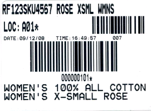

Sample RF Return Label
A sample RF Return label is presented below. This sample was printed using the base print program RFR0073. The base print program prints RF Return labels that are 2" high x 4" wide. Note: The sample label below is not to actual size. Your label may differ if you use a different print program.
Contents:
• Item number: The item number defined for the item that was returned.
• SKU code: The SKU code defined for the SKU of the item.
• Loc: A code for the item’s primary primary location. An asterisk (*) prints at the end of the location code if the location is less than 7 positions. If a primary primary location has not been defined for the item, an asterisk (*) prints in place of the location code.
• Barcode: The company barcode used to identify the company associated with the item/SKU.
• Date: The date when the item was returned, in MM/DD/YY format.
• Time: The time when the item was returned, in HH:MM:SS format.
• Company code: A code for the company associated with the item/SKU.
• Barcode: The short SKU barcode used to identify the short SKU code for the item/SKU that was returned.
• Short SKU code: The short SKU code used to identify the item and SKU. An asterisk (*) prints after the short SKU code to indicate the end of the barcode.
• Item description: The first 33 positions of the item description.
• SKU description: The first 33 positions of the SKU description.

The system prints RF Bin Location labels when you select to print an RF Bin Location label from the Bin Loc Prt Screen; see Print Bin Location Label.
Sample RF Bin Location Label
A sample RF Bin Location label is presented below. This sample was printed using the base print program RFR0072. The base print program prints RF Bin Location labels that are 1" high x 4" wide. Note: The sample label below is not to actual size. Your label may differ if you use a different print program.
Contents:
• Location code: A code for a location in a warehouse.
• Bin location barcode: The barcode for the location. An asterisk (*) displays after the location code if it is less than 7 positions.

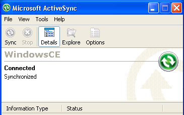

Connect the MC9090 mobile device to the Windows PC that has Microsoft ActiveSync and make sure it connects. The Microsoft ActiveSync window looks like the following when it is connected to the MC9090 mobile device:

Unzip the SerenadeRF_PocketBrowser.zip file to the desktop of the Windows PC.
3.

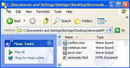

Open the SerenadeRF_PocketBrowser folder that was unzipped. This folder contains:
• Serenade folder.
• Config.xml file.
4.
Open the Serenade folder. This folder contains:
• confirm.wav file: this file is used to emit a high pitched single beep when an action on an RF screen is successful and the screen is ready to continue.
• continue.wav file: this file is used to emit a medium pitched double beep when a confirmation is required from the user on an RF screen, such as selecting OK to proceed.
• error.wav file: this file is used to emit a low pitched triple beep when an error occurs on an RF screen that requires user intervention.
• serenade.html configuration file.

6.
Return to the SerenadeRF_PocketBrowser folder and keep this folder open since it will be used in a later configuration step.
7.

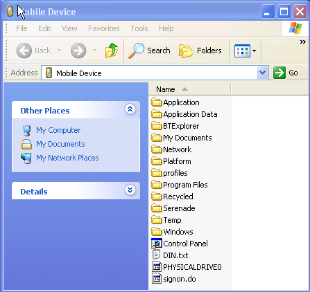

In Microsoft ActiveSync, select File > Explore to advance to the Mobile Device explorer window and keep this folder open since it will be used in the next configuration step.
8.
Use the following steps to copy information from the SerenadeRF_PocketBrowser folder to the Mobile Device explorer window.
• In the SerenadeRF_PocketBrowser folder, highlight and right-click on the Serenade folder, and select Copy to copy the Serenade folder and its contents.
• In the Mobile Device explorer window, right click and select Paste to place the Serenade folder and its contents to the main explorer directory of the Mobile Device.
• In the SerenadeRF_PocketBrowser folder, highlight and right-click on the Config.xml file, and select Copy to copy the Config.xml file.
• In the Mobile Device explorer window, advance to Program Files > PocketBrowser > Config. Right click in this directory and select Paste to place the Config.xml file in the Config directory of the Mobile Device. When you are asked if you want to replace the existing file, click Yes.
9.
Close the Mobile Device Explorer window and unplug the MC9090 mobile device from the PC.
