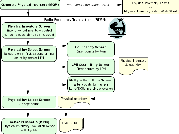

RF Physical Inventory Illustration:

RF Physical Inventory Process
Use the following steps to complete an RF Physical Inventory.
1.
Complete all processes that affect inventory. For example, complete all inventory receipts, inventory transactions, suspense placements, shipment confirmation and billing. Alternatively, you can void outstanding pick slips and cancel outstanding batch inventory transactions, work orders, and replenishments.
2.
Use the Generating a Physical Inventory (MGPI) menu option to generate the physical inventory.
• If the File Generation Output (A09) system control value is set to TICKETS, the system prints Physical Inventory Tickets to aid in the physical inventory count.
• If the File Generation Output (A09) system control value is set to SHEET, LOCATION, or AISLE, the system prints the Physical Inventory Batch Work Sheet to aid in the physical inventory count.
3.
Use an RF gun to enter a first count for each item location.
• On the Physical Inventory Screen, enter the physical inventory control number and batch number to count.
• On the Physical Inv Select Screen, select to count by LPN, item or multiple item.
• If you select to count by LPN, enter the count for each LPN using the LPN Location Screen and LPN Count Entry Screen.
• If you select to count by item, enter the count for each item on the Count Entry Screen.
• If you select to count by multiple item, enter the count for each item/SKU in a specified warehouse and location on the Multiple Item Scan Screen. Note: Entering RF physical inventory counts by multiple item is available only if the Batch Grouping (L64) system control value is set to LOCATION.
• When you have completed the first count, accept the count on the Physical Inv Select Screen.
Note: You can also use the Enter Physical Counts (MPIE) menu option to enter the first, second, or final counts; however, you cannot enter the same count for a physical inventory control number/batch number using both an RF gun and the Enter Physical Counts (MPIE) menu option.
How to display this screen: Complete the Physical Inventory Screen and select OK or press Enter; see RF Screen Layout.
Cursor placement: When you first advance to this screen, the system places the cursor in the Option field.
Identifying the physical inventory and count: The line below the screen title indicates the control number for the physical inventory and the batch number for which you are entering counts, and whether the count is the first, second, or final count. For example: #1-2 1st Count indicates you selected control number 1 for the physical inventory, you are entering counts for batch number 2, and the counts are for the first count.
Completing the Physical Inv Select Screen
Use the following steps to enter a count for a physical inventory batch and accept the count once entry is complete.
1.
Specify whether you wish to enter counts by item, LPN or multiple item.
• Enter 1 in the Option field and select OK or press Enter to enter counts by item. The system validates your entry. Select OK or press Enter again to advance to the Count Entry Screen.
• Enter 2 in the Option field and select OK or press Enter to enter counts by LPN. The system validates your entry. Select OK or press Enter again to advance to the LPN Location Screen.
• Enter 3 in the Option field and select OK or press Enter to enter counts by multiple item. The system validates your entry. Select OK or press Enter again to advance to the Multiple Item Entry Screen. Note: Entering RF physical inventory counts by multiple item is available only if the Batch Grouping (L64) system control value is set to LOCATION.
2.
Once you have completed entry for a count, you can accept it.
• Enter 4 in the Option field and select OK or press Enter to validate your entry. Select OK or press Enter again to accept the count.
• The system displays the message PI_UPLD Submitted at the bottom of the screen. This job transfers the records for the count from the Physical Inventory Upload New table to the Physical Inventory table.
• Any records in the Physical Inventory Upload New table that are in error are removed from the table and print on the Physical Inventory Scan Errors Report when you accept the physical inventory count.
Accepting the count closes it off from further entry. For example, when you accept a first count, you can no longer enter or correct item location or LPN counts for the first count; you must enter a second or final count instead.
Note: If you enter a count for an item location using both item entry and LPN entry, the system creates a separate record for each entry in the Physical Inventory Upload New table; when you process the physical inventory, the system adds the count for the two records together. For example, if you enter a count of 2 using item entry and a count of 1 using LPN entry for item ABC in location C010101, the system records the physical count for item ABC in location C010101 as 3.
Screen Option
Procedure
Enter counts by item
Enter 1 in the Option field and select OK or press Enter to advance to the Count Entry Screen.
Enter counts by LPN
Enter 2 in the Option field and select OK or press Enter to advance to the LPN Location Screen.
Enter counts by multiple item
Enter 3 in the Option field and select OK or press Enter to advance to the Multiple Item Entry Screen. Note: Entering RF physical inventory counts by multiple item is available only if the Batch Grouping (L64) system control value is set to LOCATION.
Accept a count
Enter 4 in the Option field and select OK or press Enter to accept the physical inventory count. The system transfers the records for the count from the Physical Inventory Upload New table to the Physical Inventory table.
See Printing the Physical Inventory Evaluation Variance Report with Update for more information on completing a physical inventory and see Updating CWSerenade with Physical Inventory Counts for the updates that take place when you run the Physical Inventory Evaluation Report with Update under Printing Physical Inventory Reports (MPIR).
