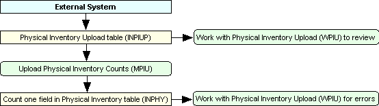

If you are uploading counts from an external system:
blank
NONE or blank
Selected
Use Uploading Physical Counts (MPIU) to upload counts from an external system.
SHEET
Any value except TICKETS
Selected
Use Uploading Physical Counts (MPIU) to upload counts from an external system and enter the second and final counts using the Entering Physical Counts by Worksheets (MPIE) menu option. If the File Generation Output (A09) system control value is set to SHEET, LOCATION, or AISLE, the system prints the Physical Inventory Batch Work Sheet to aid in the count.
TICKETS
TICKETS
Selected
Use Uploading Physical Counts (MPIU) to upload counts from an external system and enter the second and final counts using the Entering Physical Counts by Tickets (MPIE) menu option. The system prints Physical Inventory Tickets to aid in the count.

Uploading Physical Inventory Counts from an External System
Use the following steps if you upload counts from an external system:
• Use the Working with File Uploads (WUPL) menu option to upload records to the Physical Inventory Upload table.
• Use the Uploading Physical Counts (MPIU) menu option to transfer the counts from the Physical Inventory Upload table to the Physical Inventory table.
• If there are resulting errors, use the Work with Physical Inventory Upload Screen to review and correct them.
