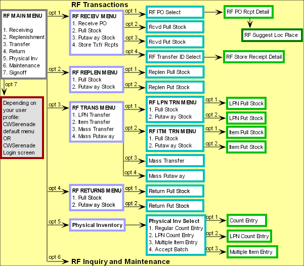

RF Screen Layout
A layout of the RF screens is presented below.
RF Transactions:

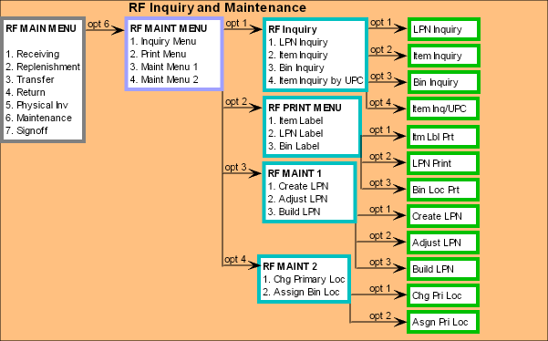

RF Inquiry and Maintenance:
RF MAIN MENU Screen
Purpose: Use this screen to select the RF transaction you wish to perform.
How to display this screen:
• Enter RFMN in the Fast path field or select RF Main from a menu.
• If your user profile is set up to use the *RFMENU as the default menu, you advance to the RF MAIN MENU screen as soon as you log in to CWSerenade; see Assigning the RF Menu to a User or User Class.
See RF Screen Layout for an outline of the RF screens.
See Available RF Transactions for a list of the transactions that you can perform using the Radio Frequency Transactions (RFMN) menu option.

Perform inquiry, print labels, maintain LPN records, and work with item/location records
Select option 6. Maintenance and select OK or press Enter to advance to the RF MAINT MENU Screen.
See Radio Frequency Inquiry and Maintenance (RFMN).
