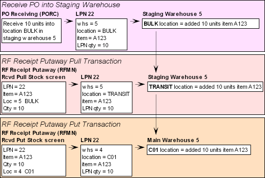

RF Receipt Putaway Example
You have received a case of 10 units into location BULK in staging warehouse 5. The system has assigned LPN 22 to the case. You need to put the case away in location C01, a bulk location in main warehouse 4.
The RF transactions to perform are:
• RF Receipt Putaway Pull transaction: Pull the LPN from location BULK in staging warehouse 5. The system transfers the LPN to the TRANSIT location in staging warehouse 5.
• RF Receipt Putaway Put transaction: Put the LPN in location C01 in main warehouse 4. The system transfers the LPN out of the TRANSIT location in staging warehouse 5 and into the C01 location in main warehouse 4. Because the system did not put the stock in its primary location, the system does not delete the LPN record at this time.
RF Receipt Putaway Illustration

Warehouse Default
• If the Default Primary Warehouse in RF (G32) system control value is unselected, the warehouse code defined in the Default Warehouse (A04) system control value defaults, but you can override it.
• If the Default Primary Warehouse in RF (G32) system control value is selected, once you enter an LPN, the system defaults the item’s primary warehouse, but you can override it.
Numeric, 3 positions; display-only.
Loc
Location
The location in the warehouse where you wish to put the stock associated with the LPN.
Location codes are defined in and validated against the Location table.
Scanning the Location Barcode on the Bin Location Label
To scan the bin location barcode on the RF Bin Location Label correctly, the cursor on the screen must be in the Loc field.
Alphanumeric, 7 positions; required.
Screen Option
Procedure
Process the RF Receipt Putaway Put transaction
See RF Receipt Putaway Put Process for instructions.
Process an RF Receipt Putaway Pull transaction for another LPN
Select Pull or press F7 to advance to the Rcvd Pull Stock Screen.
Clear the information from the screen and restore the defaults
Select Clr or press F8.
Exit the screen
Select Exit or press F3.
