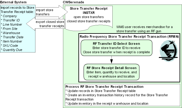

RF Store Transfer Receipt Transaction
RF Store Transfer Receipt allows you to receive a store transfer line defined in the Store Transfer Receipt Table (INSTXR) into a specified warehouse and location using an RF gun to scan the item to receive and the location where the item will be placed. You can receive the entire store transfer line or receive a partial quantity of the store transfer line. You can also process store transfer receipts using the Working with Store Transfer Receipt (WSRT) menu option. The lines on a store transfer remain open until you close the store transfer.
RF Store Transfer Receipt Illustration:

RF Store Transfer Receipt Process
Use the following steps to complete an RF Store Transfer Receipt transaction.
1.
Use the RF Transfer ID Select Screen to enter the store transfer ID you wish to receive. In order to receive an item on a store transfer, the store transfer line must be in an Open (O) status in the Store Transfer Receipt Table (INSTXR).
2.
Use the RF Store Receipt Detail Screen to:
• Enter or scan the item you wish to receive.
• Enter the quantity you wish to receive.
• Enter or scan the location where you wish to receive the quantity.
3.
When you complete the RF Store Transfer Receipt transaction, the system updates the Store Transfer Receipt record in the Store Transfer Receipt Table (INSTXR) and the inventory information in the location and warehouse where the item was placed.
