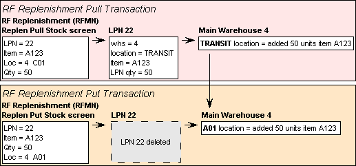

RF Replenishment Example
You currently have a case of 50 units in location C01 in main warehouse 4. You need to put the case away in location A01, the item's primary location in main warehouse 4.
The RF transactions to perform are:
• RF Replenishment Pull transaction: Pull the LPN from location C01 in main warehouse 4. The system transfers the LPN to the TRANSIT location in main warehouse 4.
• RF Replenishment Put transaction: Put the LPN in location A01 in main warehouse 4. The system transfers the LPN from the TRANSIT location in main warehouse 4 to the A01 location in main warehouse 4. Because location A01 is the item’s primary location, the system deletes the LPN record.
RF Replenishment Illustration

Process the RF Replenishment Put transaction
See RF Replenishment Put Process for instructions.
Process an RF Replenishment Pull Transaction for another LPN
Select Pull or press F7 to advance to the Replen Pull Stock Screen; see RF Replenishment Pull Transaction.
