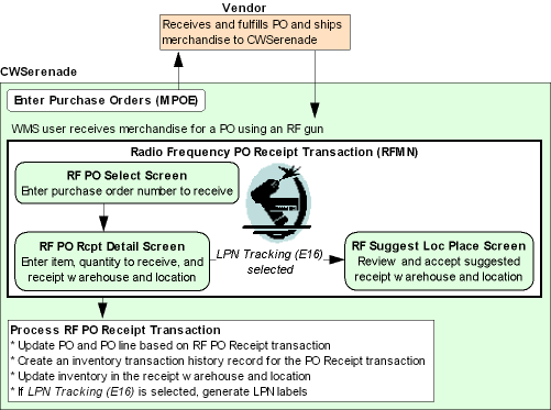

RF PO Receipt Illustration:

Use the following steps to complete an RF PO Receipt transaction.
1.
Use the RF PO Select Screen to enter or scan the purchase order number you wish to receive. In order to receive an item on a PO, the PO must be in an Open or Docked status. In addition, the PO line must also be in an Open status.
2.
Use the RFPODTL (RF PO Receipt Detail) Screen to enter or scan the item and the quantity of the item you wish to receive.
Enter or scan the warehouse and location where you wish to receive the quantity, or optionally, if the LPN Tracking (E16) system control value is selected, use the RF Suggest Loc Place Screen to have the system suggest the warehouse and location(s) where the quantity should be received.
In addition, if the LPN Tracking (E16) system control value is selected and the Default Quantity in RF Receiving (K71) system control value is not set to *ONE, you can update the Pieces per case quantity for an item in the Item table. The system uses the updated case quantity during suggest location placement and LPN generation. See Updating Pieces Per Case Quantity During RF PO Receiving.
3.
When you complete the RF PO Receipt transaction, the system updates the PO and the inventory information in the location and warehouse where the item/SKU was placed.
If the LPN Tracking (E16) system control value is selected, and you received the item into a non-primary location, the system generates an RF LPN Label for the quantity received.

RF PO Select Screen
How to display this screen: Select option 1. Receive PO and select OK or press Enter at the RF RECEIV MENU Screen; see RF Screen Layout.
Cursor placement: When you first advance to this screen, the system places the cursor in the PO# field.
Completing the RF PO Select Screen
Use the following steps to select a PO for RF PO Receipt.
1. Optionally, enter the company associated with the PO you wish to receive in the Cmp field. The code for the company you are currently in defaults, but you can override it.
2. Optionally, use the Price Tags Option field to indicate whether you wish to create a price tag batch and print price tags for the items on the PO that are assigned to a price tag type. Note: This field displays only if records exist in the Price Tag Type table for your company. See Creating a Price Tag Batch for an RF PO Receipt Transaction for more information.
3. Scan the purchase order number barcode located in the upper right corner of the PO receiving worksheet or enter the purchase order number you wish to receive in the PO# field. Set the PO Receiving Worksheet Print Program (I36) system control value to POR0167BC or POR0740BC to print the purchase order and item/SKU barcodes on the PO receiving worksheets.
4. Select OK or press Enter to validate your entries. See RF PO Select Screen Errors for a list of errors you can receive on this screen.
5. Select OK or press Enter again to advance to the RFPODTL (RF PO Receipt Detail) Screen, where you can specify the quantity you wish to receive for an item on the PO.

Receiving an Item on a PO
Purpose: Use the RF PO Receipt Detail screen to receive an item on the specified PO. You can enter the quantity you wish to receive and the warehouse and location where you wish to place the item.
In order to receive a full or partial PO line, the PO line must be in an Open status. In addition, the item location cannot be on physical freeze. Note: The system allows the item location to be on reservation freeze and the item warehouse to be on allocation freeze. In addition, the system allows the location to be frozen.
Standard or Streamlined RF PO Rcpt Detail screen? A setting in the ServicesTable_System.properties file defines whether the standard or streamlined version of the RFPODTL (RF PO Receipt Detail) Screen displays:
• Enter Rfr0121=com.cwdirect.pt.rf.Rfr0121CvBean to call the streamlined version of the RF PO Rcpt Detail screen. This screen contains the following fields:
How to display this screen: Complete the RF PO Select Screen and select OK or press Enter; see RF Screen Layout.
Cursor placement: When you first advance to this screen, the system places the cursor in the UPC or SS field.
Completing the RF PO Rcpt Detail Screen
