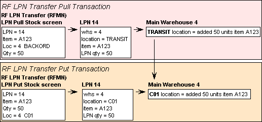

An RF LPN Transfer transaction consists of two transactions:
• RF LPN Transfer Pull transaction: Use the LPN Pull Stock Screen to pull the LPN from its current location. When you process an RF LPN Transfer Pull transaction, the system transfers the LPN from its current location to the intransit location in the same warehouse. See RF LPN Transfer Pull Transaction.
• RF LPN Transfer Put transaction: Use the LPN Put Stock Screen to put the LPN into a specified warehouse and location. When you process an RF LPN Transfer Put transaction, the system transfers the LPN from the intransit location to the specified warehouse and location. In addition, if you put the stock in a primary location, the system deletes the LPN record at this time. See RF LPN Transfer Put Transaction.
RF LPN Transfer Example
You currently have a 50 unit case of item A123 in location BACKORD in main warehouse 4. You have fulfilled all of your outstanding backorders for this item and want to transfer this leftover case to bulk storage location C01 in main warehouse 4.
The RF transactions to perform are:
• RF LPN Transfer Pull transaction: Pull the LPN from location BACKORD in main warehouse 4. The system transfers the LPN to the TRANSIT location in main warehouse 4.
• RF LPN Transfer Put transaction: Put the LPN in location C01 in main warehouse 4. The system transfers the LPN from the TRANSIT location in main warehouse 4 to the C01 location in main warehouse 4. Because the system did not put the stock in a primary location, the system does not delete the LPN record at this time.

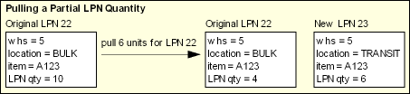

Pulling a Partial LPN Quantity for an RF LPN Transfer Pull Transaction
If you partially pull the LPN quantity, the system creates a new RF LPN Label for the quantity in transit and leaves the existing LPN with the quantity remaining in the current location. The system looks at the setting of the Suppress Labels for RF LPN Transfers (L57) system control value:
• If this system control value is unselected, the system prints the new LPN label and displays the following message on the LPN Pull Stock screen: Pull Processed.
• If this system control value is selected, the system does not print the new LPN label and instead advances you to the LPN Created Screen where you can review the new LPN created. Select OK or press Enter on this screen to return to the LPN Pull Stock screen; the system displays the following message: Pull Processed. You can print the new LPN label using the Print LPN Label option in Radio Frequency Inquiry and Maintenance (RFMN).
LPN creation history: When a new LPN is created, the system also creates a record in the LPN Creation History table, providing details of the LPN: LPN number, associated PO number (if any), LPN quantity, date and time created, item/SKU, warehouse, location, user ID, and the program that created the LPN.
Example: If the quantity for LPN 22 is 10, but you select to pull 6, the system assigns a new LPN number to the 6 units pulled and leaves LPN 22 with the remaining 4 units in the staging warehouse.
If you enter a quantity smaller than the LPN quantity in order to pull only part of the LPN, the system assigns a new LPN to the quantity in transit and leaves the existing LPN with the quantity remaining in the staging warehouse location. The system looks at the setting of the Suppress Labels for RF LPN Transfers (L57) system control value to determine whether to print the LPN label:
• If unselected, the system immediately prints the new LPN label.
• If selected, the system does not print the new LPN label and instead advances you to the LPN Created Screen where you can review the contents of the LPN label. You can print the new LPN label using the Print LPN Label option in Radio Frequency Inquiry and Maintenance (RFMN). Select OK on this screen to return to the LPN Pull Stock Screen.
See Pulling a Partial LPN Quantity for an RF LPN Transfer Pull Transaction for an example.

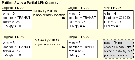

Putting Away a Partial LPN Quantity for an RF LPN Transfer Put Transaction
If you enter a quantity smaller than the LPN quantity in order to put away only part of the LPN, the system assigns a new LPN to the quantity put away and leaves the existing LPN with the quantity remaining in the intransit location. If the LPN is put away in a non-primary location, the system assigns a new LPN to the quantity put away; if the LPN is put away in a primary location, the system does not create a new LPN.
Example: If the quantity for LPN 22 is 10, but you select to putaway 6 in a non-primary location, the system assigns a new LPN number to the 6 units put away and leaves LPN 22 with the remaining 4 units in the staging warehouse. Likewise, if the quantity for LPN 25 is 10, but you select to putaway 8 in a primary location, the system leaves LPN 25 with the remaining 2 units in the intransit location and does not create a new LPN for the 8 that have been put away.
If you enter a quantity smaller than the LPN quantity in order to put away only part of the LPN, the system assigns a new LPN to the quantity put away and leaves the existing LPN with the quantity remaining in the intransit location. If the LPN is put away in a non-primary location, the system assigns a new LPN to the quantity put away; if the LPN is put away in a primary location, the system does not create a new LPN. See Putting Away a Partial LPN Quantity for an RF LPN Transfer Put Transaction for an example.
Numeric, 7 positions; required.
