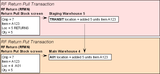

RF Return Example
A customer returns two units of item A123. When you process the return in Order Maintenance, you have the system place the units in location RETURNS in staging warehouse 5. You want to return the stock to its primary primary location A01 in main warehouse 4.
The RF transactions to perform are:
• RF Return Pull transaction: Pull the return quantity from location RETURNS in staging warehouse 5. The system transfers the return quantity to the TRANSIT location in staging warehouse 5.
• RF Return Put transaction: Put the return quantity in its primary primary location A01 in main warehouse 4. The system transfers the return quantity from the TRANSIT location in staging warehouse 5 to the A01 location in main warehouse 4.
RF Return Illustration

1 defaults, but you can override it.
Numeric, 7 positions; required.
Screen Option
Procedure
Process the RF Return Put transaction
See RF Return Put Process for instructions.
Process an RF Return Pull transaction
Select Pull or press F7 to advance to the Return Pull Stock Screen; see RF Return Pull Transaction.
Clear the information from the screen and restore the defaults
Select Clr or press F8.
Exit the screen
Select Exit or press F3.
