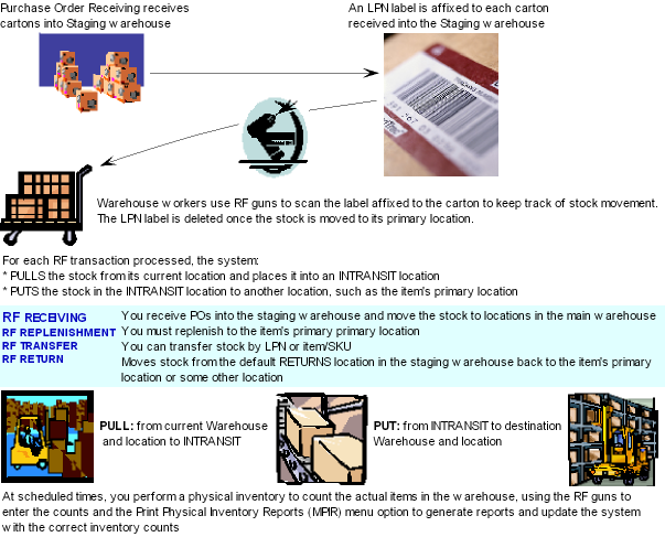

License Plate Number Tracking
You can track inventory movement through license plate numbers (LPNs). The system assigns an LPN to each case, carton or container when you receive a purchase order, based on the Pieces per case quantity defined for the item. For example, if item AA100 is defined with a Pieces per case of 12, the system will assign 4 unique LPNs when you receive a quantity of 48. You print the LPN labels and affix them to each carton. The LPN label includes a barcode that you can scan as you move the carton from one location to another.
The system keeps track of each LPN's item/SKU, quantity, and location until you put the LPN away in its primary picking location; at this point, the LPN is deleted. You can review LPNs in Displaying License Plate Information (WLPN). The system also creates a record in the LPN Creation History table when an LPN is created through Receiving, Physical Inventory, Inventory Transaction, or the Create LPN Screen.
Suggest Location Placement
If you use LPN tracking, the system uses a different process to suggest location placement at purchase order receipt than the standard suggestion routine. The system will consider each item's minimum and maximum settings in the primary location and its current backorders. However, the system suggests you place the stock in a staging warehouse, which may be defined separately on your system from your main warehouse. See Staging Warehouse/Location Placement for more information on how the system determines where merchandise should be placed in the staging warehouse.
Staging Warehouse
The staging warehouse is the area in your warehouse where received inventory awaits putaway. You use default locations in your staging warehouse to refer to actual locations in your main warehouse. For example, if you need to replenish an item's primary location, you would place stock in the staging warehouse, in a location named PRIMARY. The LPN label will display both this location code and the item's actual primary location, to facilitate putaway in the main warehouse.
Warehouse Workers
You can set up warehouse employees who will always use the RF gun so that they advance directly to the Radio Frequency Transactions (RFMN) menu when they log on; see Assigning the RF Menu to a User or User Class.
In addition, you can use secured features to control each employee's access to the various RF functions; see Secured Features Related to RF.
Inventory Transactions Outside of RF
Any inventory transaction that occurs in CWSerenade but outside of RF, with the exception of purchase order receiving, will not update LPN records. This means that certain actions such as immediate or batch inventory transactions may cause a discrepancy between your actual on-hand quantity in a location and the quantity assigned to LPNs. You can print the Item Location/LPN Discrepancy Report to review items in your warehouses whose item/location quantity does not equal the total quantity assigned to LPNs. You can use the LPN maintenance options in Radio Frequency Transactions (RFMN) or Displaying License Plate Information (WLPN) to correct these discrepancies.
Radio Frequency Illustration
