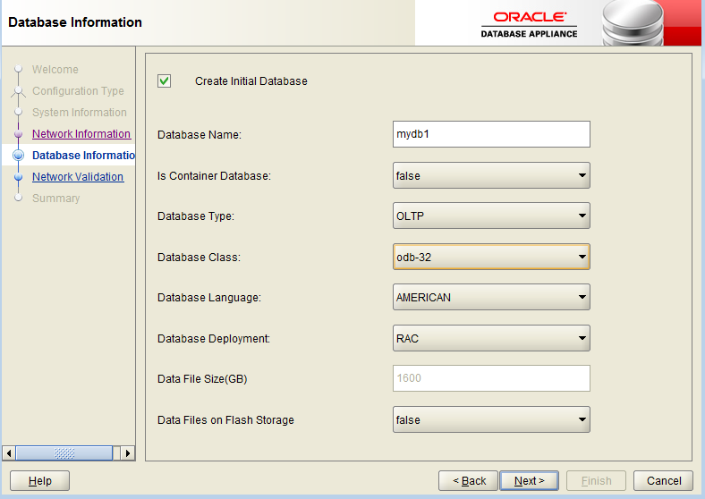

Oracle Database Appliance software includes preconfigured templates that incorporate Oracle best practices with optimization for different classes of databases. Due to differences in CPU counts, memory size, and other resources available with different Oracle Database Appliance models, some templates are not supported on all models.
Each database template has different workload profile and performance characteristics based on the following:
memory requirements, calculated from the System Global Area (SGA) plus Program Global Area (PGA) sizes
processing requirements, calculated from the number of processes
logging requirements, based on log buffer size and online redo log size
To determine which templates to use for the databases you deploy, use the guidelines from Appendix B (Database Sizing for Oracle Database Appliance) in Oracle Database Appliance Administration and Reference Guide. Then refer to Table 2-1 to check if a particular template is available on your Oracle Database Appliance hardware model. Templates that do not have a corresponding "X" in a model column are not available on that model.

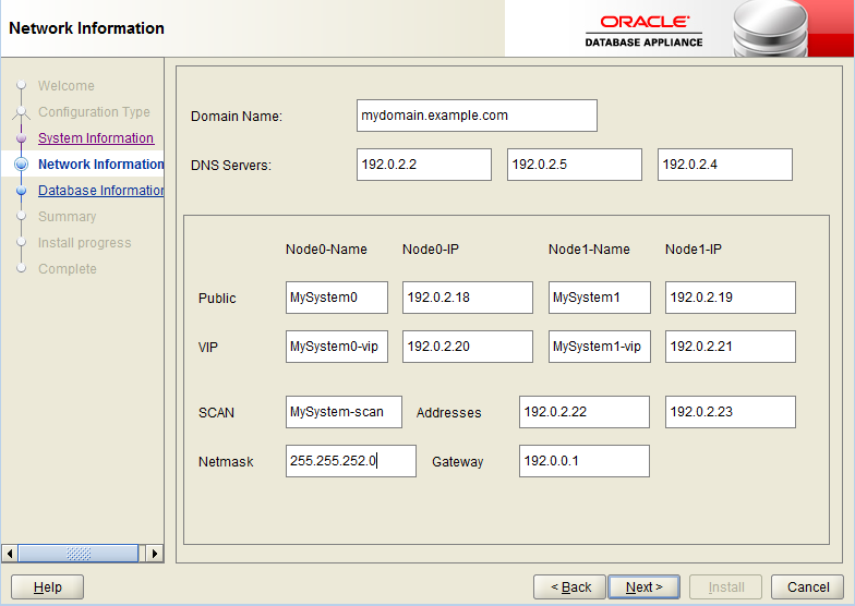

Confirm with your network administrator that the IP addresses to be configured for Oracle Database Appliance meet these three criteria:
They are static IP addresses.
They are on the same subnet as all other IP addresses, virtual IP (VIP) addresses (used for Real Application Clusters communication), and SCAN addresses.
They include the following:
One public IP address configured on the DNS server for each node and resolvable to that node before installation.
A VIP address for each node configured on the DNS server that is not currently in use.
SCANs for Oracle Database Appliance with the following characteristics:
Configured on the DNS server before installation so that the two IP addresses are associated with the name provided as the SCAN, and both addresses are returned in random order to the requester by the DNS server
Configured on the DNS server before installation to resolve to addresses that are not currently in use
Have names that do not begin with a numeral

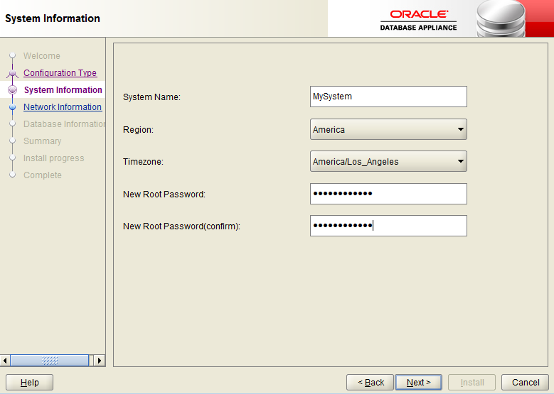

Do not use a host name with more than 13 characters. Additionally, Oracle recommends that you use all lower case characters for the host name. The names are generated as follows: If you provide mysystem as the name of your system then the derived host names are mysystem0 and mysystem1; the derived host vip names are mysystem0-vip and mysystem1-vip and the ILOM names are mysystem0-ilom and mysystem1-ilom.Note:
You will need to provide a new password for the root user during deployment. However, there is no entry for this password in the preceding table because this is not a value that you should write down.By default, names for network interfaces are derived from the Oracle Database Appliance system name, which you provide during installation. Also, when using the Oracle Appliance Manager configurator, the addresses for the public IP addresses can be automatically assigned in a sequence starting with the address you provide for the public IP address for Node 0. The other IP addresses generated are, in order, the public address for Node 1, the virtual IP address for Node 0, the virtual IP address for Node 1, and the SCAN addresses.

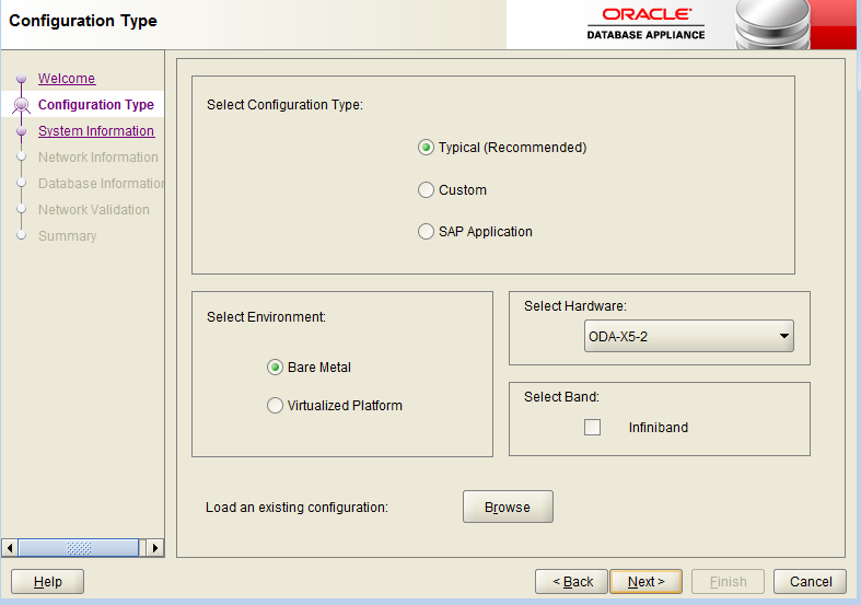

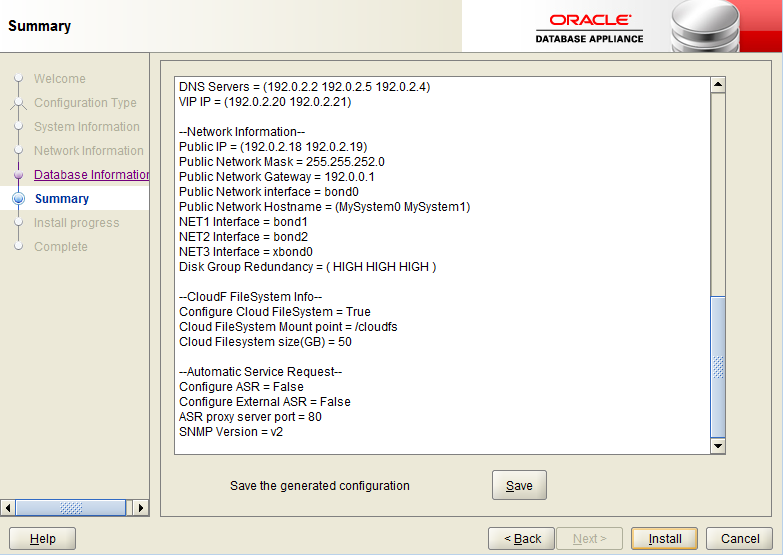

Use the standalone Oracle Database Appliance configurator to create an offline deployment plan and validate your network settings before the actual deployment. However, if you prefer to configure your system at the time you deploy it, you can wait and use the online configurator that is part of the base Oracle Database Appliance software.
The standalone Oracle Appliance Manager configurator is a Java-based tool that enables you to generate your deployment plan and validate your network settings before the actual deployment.
If you want to use this tool before deployment, then you must download and run the configurator on a local client system which can be a Linux, UNIX, MAC, or Windows system.
At the end of an offline configurator session, you can save your deployment plan in a configuration file. When you are ready to deploy, copy this configuration file to Oracle Database Appliance and run the online Oracle Appliance Manager configurator to import and deploy your saved plan. You can also print the file's content and use the printout as a checklist for setting up your external network configuration.
Prior to saving your configuration file, Oracle recommends that you test your network settings. However, this will only work correctly if your client system is connected to same network that you will use for Oracle Database Appliance.
To run the standalone Oracle Database Appliance configurator:
Download the standalone Oracle Appliance Manager configurator that matches your version of Oracle Database Appliance software.
All versions of the configurator are available from the Overview page by clicking the "Oracle Database Appliance Manager Configurator" link at
http://www.oracle.com/technetwork/database/database-appliance/overview/index.html

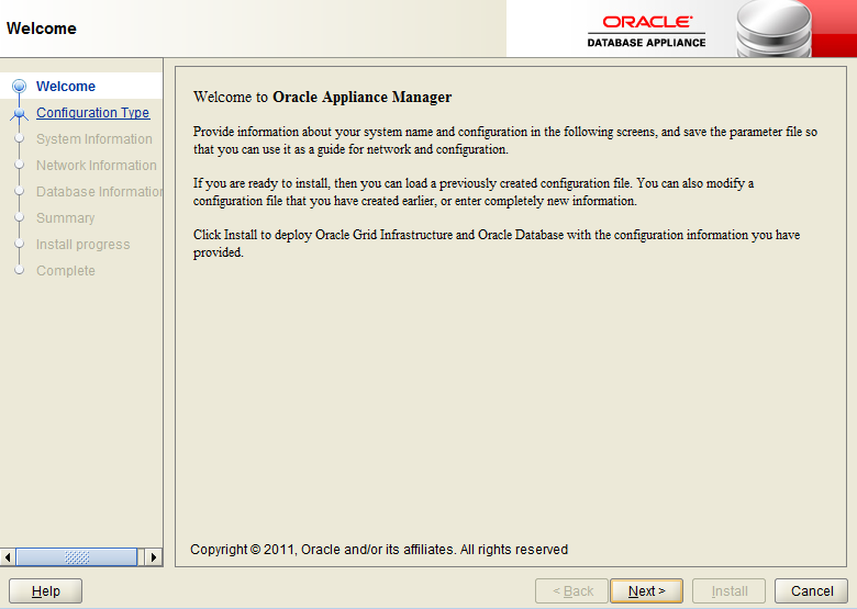

Start the configurator using the command config.bat on a Windows client, or the command ./config.sh on a Linux or UNIX client.
The Oracle Appliance Manager Welcome page appears.
Click Next.
On the Configuration Type page, select the options for configuration type, environment, and hardware model. You can optionally load an existing configuration file by clicking Browse.
Oracle recommends the typical configuration except for SAP databases and applications, in which case select SAP Application. Choose the Custom option to configure additional or alternate network interfaces or to override the default values for one or more of the following:
Database block size, language, territory, backup file location, or disk redundancy level for the DATA and RECO disk groups
To see the default values for your version of Oracle Database Appliance software before choosing the Typical or Custom option, run the configurator using the Custom option.
If you are installing Oracle Database Appliance Virtualized Platform, then select Virtualized Platform. Otherwise, leave the default value, Bare Metal, as the environment option. If you are installing on X3-2, X4-2, or X5-2 hardware, then select ODA-X3-2, ODA-X4-2 or ODA-X5-2 respectively, or leave the default value, ODA V1, as the hardware option.
If you are using InfiniBand as the interconnect between the two Oracle Database Appliance servers, select the Infiniband checkbox. This option is only available for Oracle Database Appliance X5-2 systems.
The Browse option is not useful during the initial run because there are no configuration files to load.
In this example, Typical, Virtualized Platform, and ODA-X5-2 are the selected options.
The SAP Application option is only valid with the Bare Metal option.Click Next.
On the System Information page, provide the system name, and select the correct value from the lists for your region and time zone.
In the New Root Password and New Root Password (confirm) fields, enter a new password for the root user. This password is encrypted in the configuration file and will be temporarily decrypted to reset the password during deployment.
Click Next.
On the Network Information page, provide your domain name, DNS server addresses, public and VIP addresses for your two nodes, SCAN name and addresses, and Netmask and Gateway addresses.
As you enter data on this page, some fields will automatically fill with values derived from earlier entries. For example, if the address that you provide for the Node 0 public IP address is 192.0.2.18, then the default node addresses are generated as follows. Note that the default generated network names and IP addresses can be changed as desired.
Node 1 public IP address: 192.0.2.19
Node 1 virtual IP (VIP) address: 192.0.2.21
SCAN addresses (two addresses resolving to the SCAN VIP name): 192.0.2.22, 192.0.2.23
See Also:
"Checklist for Custom Node Network Address Configuration" earlier in this chapter for information about requirements for nonstandard public IP addressesClick Next.
On the Database Information page, select whether you want to create an initial database. If you check the box to create a database, then you can also provide your database details. These details include the database name, which you must enter, and the following options, selected from the available list values:
Is Container Database: leaving the default value, false, will build a non-container database
Database Type: the default type is OLTP, or you can select DSS or In-Memory
Database Class: see "Selecting Database Templates" for guidelines to help you choose the appropriate template, noting that not all options are available for all models of Oracle Database Appliance; the default class is odb-06
Database Deployment: select one of the following, where RAC is the default:
Data File Size (GB): if you indicated that you want to build a container database, then you need to provide a database data file size in the final field on the page. (This field does not accept input unless the Is Container Database selection is True.) If you do not want to create an initial database, then do not check the Create Initial Database check box.
Data Files on Flash Storage: select true if you plan to store your entire database in flash storage (400 GB SSDs); otherwise, leave the selection false. This option is only available on Oracle Database Appliance X5-2 systems.
Click Next.

On the Summary page, review the configuration options that you have selected. Click Save to save the configuration file, or click Back to modify your selections.
You can print the contents of the configuration file and use the printout to review your configuration entries for deployment planning purposes. You might also use the configuration file during the actual deployment, as described in "Task 5: Deploy Your Configuration (All Platform Deployments)".
If you are running the configurator on Oracle Database Appliance and have completed the preliminary steps to configure your initial network and install the End-User Bundle or deploy ODA_BASE, then you can click Install to deploy the configuration that you just created. If you are not ready to complete the deployment, then first click Save and then click Finish. Remember the name and location of the file you save as you might wish to copy the file to your Oracle Database Appliance, as described in Chapter 4, "Deploying Oracle Software on Oracle Database Appliance." If you need to make corrections before deployment, then rerun the standalone Oracle Appliance Manager configurator, load your configuration file, make the changes, and save the file again.
