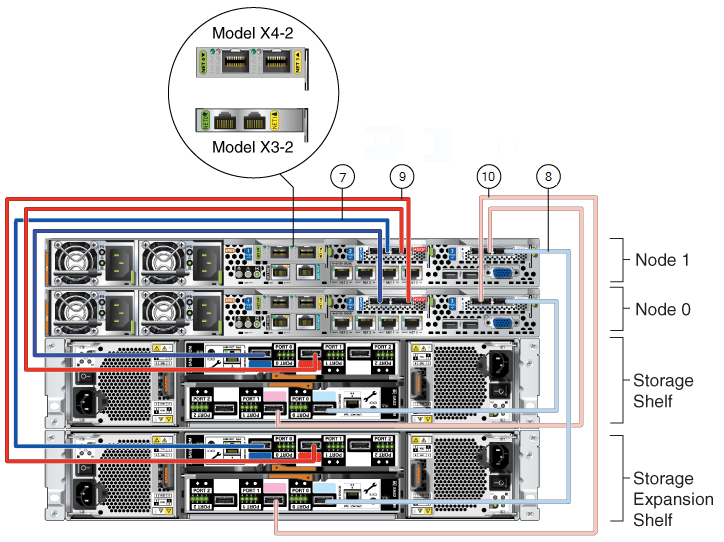

If you are able to distinguish colors, match the colors of the labels at the ends of each cable with the colored line shown in the following illustration. Also match the cable colors to the background colors of the socket identification labels.
If you are unable to use color coding, then use the callout numbers described in Table 3-2 to complete the cabling of the storage expansion shelf. Because all cables with the same terminations are interchangeable, you can ignore the color coding.

The cables identified with callout numbers in Figure 3-4 and Figure 3-5 and described in Table 3-2 are included with each shipped Oracle Database Appliance storage expansion shelf. These cables are all black, but have colored labels at each end that match the references to cable colors in the text and the label colors on the back panels.
The back panel of each node contains three PCIe generation 3 terminal slots, with two sockets in each slot. The PCIe slots are labeled "X PCIe3," where "X" is the PCIe slot number. Table 3-2 identifies these slots as PCIe slot 1, PCIe slot 2, and PCIe slot 3, which matches the numbers on the labels reading from left to right. The storage expansion shelf back panel has two IO modules, one located above the other. Each IO module has three ports, numbered 0, 1, and 2. Table 3-2 identifies these ports as either "top" or "bottom" ports, for ports in the upper and in the lower IO module respectively.Table 3-2 Description of Callouts for Cabling Oracle Database Appliance Storage Expansion Shelf
| Callout Number from Figure 3-4 and Figure 3-5 | Description |
7 |
Dark blue SAS cable:
8 |
Light blue SAS cable:
9 |
Dark red SAS cable:
10 |
Light red SAS cable:

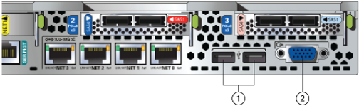

Figure 3-6 Peripheral Device Connections for Oracle Database Appliance (Node 0)
Figure 3-7 Peripheral Device Connections for Oracle Database Appliance Version 1 (Node 0)
To ready Oracle Database Appliance for the powering on the first time, you need to attach all of the required power cords, which differ between models and options, and confirm that initialization completes successfully. You can then start up the system by switching on the process server nodes.

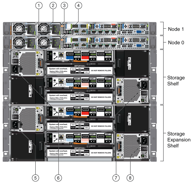

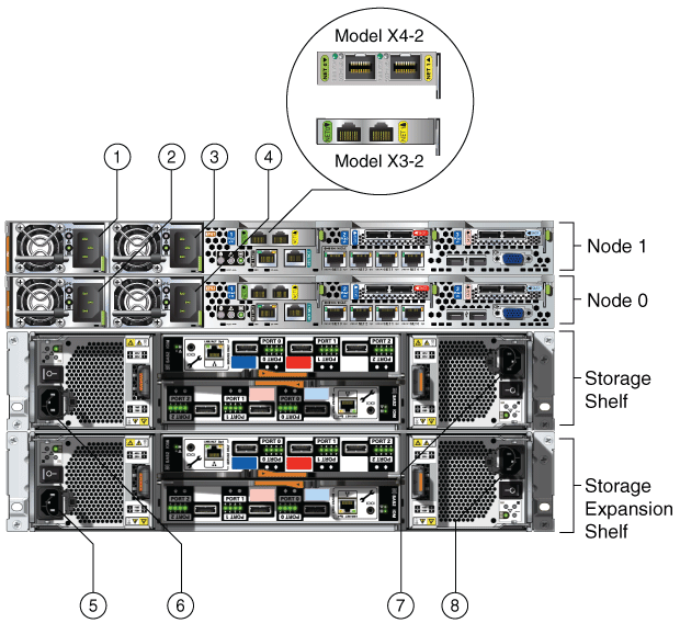

Use the callouts in Figure 3-8 and Figure 3-9 and Table 3-3 as guides to insert the supplied power cords into Oracle Database Appliance models with external storage. Ensure that the electrical outlets providing the power are grounded before plugging in the power cords.
Figure 3-8 Power Cord Connections on Oracle Database Appliance X5-2
Figure 3-9 Power Cord Connections on Oracle Database Appliance X4-2 and X3-2
If you only use a single AC circuit, connect both power cords for each component to that circuit. However, to maintain N+1 power supply redundancy, use two separate AC circuits. Then, for both nodes and the storage shelf or shelves, connect one power cord from each AC circuit into each component. See the following table, where the two separate AC circuits are denoted by AC1 and AC2, for the recommended power connections as identified by the callouts in the preceding figure.

| Callout Number from Figure 3-8 and Figure 3-9 | Component | AC Circuit |
1 |
Node 1 |
AC1 |
2 |
Node 0 |
AC1 |
3 |
Node 1 |
AC2 |
4 |
Node 0 |
AC2 |
5 |
Storage expansion shelf (Not required for single storage shelf implementations) |
AC1 |
6 |
Storage shelf |
AC1 |
7 |
Storage shelf |
AC2 |
8 |
AC2 |
