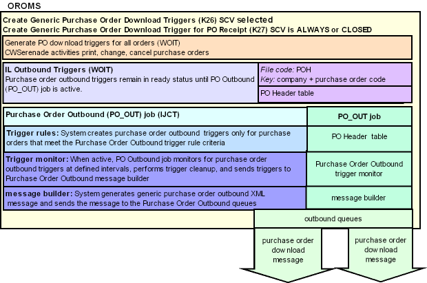

Purchase Order Download Process
The system creates a trigger in the IL Outbound Trigger table when you print a purchase order.
The IL Outbound Trigger table acts as a “to do” list for the purchase order information that requires download.
The PO Outbound (PO_OUT) job in the Working with Integration Layer Processes (IJCT) menu option monitors the IL Outbound table for purchase order download triggers to process, and generates the PO Download XML Message (CWPurchaseOrderOut) to send to the remote system.
API information flow:

When are Purchase Order Download Triggers Created?
The Create Generic PO Download Triggers (K26) system control value indicates whether to create purchase order download triggers when you print or reprint a purchase order.
Identifying download purchase orders: When the system creates the trigger, it sets the Extracted flag? in the Purchase Order Header table to Y. This flag is not displayed on any screen.
Generate for all vendors? The Use WMS Integration (K25) system control value identifies whether you use a warehouse management system integration with Order Management System. If this system control value is selected, the system generates purchase order trigger records for all vendors; otherwise, the system generates triggers only for vendors whose EDI/PO flag in Working with Vendors (WVEN) is selected.
Note: When the system creates a purchase order download trigger for an EDI vendor, it sets the EDI date in the PO Header table to the current date. This occurs regardless of the setting of the Use WMS Integration (K25) system control value.
Generating download triggers in purchase order receiving: The Create Generic PO Download Trigger for PO Receipt (K27) system control value indicates when to create a trigger when you receive a purchase order through Receiving Purchase Orders (PORC) or the Purchase Order Receipt In API, as well as when you cancel a purchase order. If this system control value is set to:
• ALWAYS = the system generates a trigger record whether you receive the purchase order partially or completely, or when you cancel a purchase order.
• CLOSED = the system generates a trigger record only when you close the entire purchase order through the receipt process.
• NEVER or blank = the system does not generate a trigger record as a result of purchase order receipts or cancellations.
The system closes a purchase order when you receive the full quantity ordered, or if the receipt quantity does not breech the Under Receipt % (A62).

Generating the Purchase Order Download Message
To generate a PO Download XML Message (CWPurchaseOrderOut), the PO_OUT process in Working with Integration Layer Processes (IJCT):
• looks for purchase order download triggers with the File code POH and a status of ready (R).
• removes duplicate purchase order download triggers. See Purchase Order Download Trigger Cleanup.
• determines which purchase order to download, based on the Key for the trigger.
• generates the PO Download XML Message (CWPurchaseOrderOut) for each trigger
• changes the status of the trigger to processed (X).

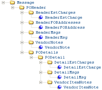

The purchase order download message contains the entire purchase order, including open, closed, and canceled lines.

POHeader Each purchase order download message contains one PO Header element. See Work with Purchase Order Screen (Header) or Purchase Order Inquiry (MPOI) for more information on the fields in the PO Header table. |

HeaderEstCharge The HeaderEstCharge element and its attributes repeat for each estimated charge applied to the purchase order header. This element is included only if there are estimated charges for the purchase order header. See Defining Estimated Charges for an overview. |
charge_code |
alpha |

HeaderFOBAddress The HeaderFOBAddress element and its attributes repeat for each FOB address entered for the purchase order header or that defaulted from the vendor. This element is included only if there are any FOB addresses for the purchase order. See Work with FOB for Purchase Order Screen for an overview. |
seq_nbr |
numeric |
3 |
A sequence number assigned to each FOB address on a purchase order. From the FOB Seq # in the PO FOB Address table. |

HeaderMsg The HeaderMsg element and its attributes repeat for each header message that is flagged to print on the purchase order, receiving worksheet, or both. This element is included only if there are any header messages flagged to print for the purchase order. See Work with PO Messages Screen for an overview. |
seq_nbr |
numeric |
3 |
A sequential number assigned by the system to each header message. From the Seq # in the PO Message table. |

VendorNote The VendorNote element and its attributes repeat for each vendor note that is flagged to print. This element is included only if there are any vendor notes flagged to print. See Work with Vendor Notes Screen for an overview. |
seq_nbr |
numeric |
3 |
A sequential number assigned by the system to each vendor note. From the Seq # in the Vendor Notes table. |

PODetail The PO Detail element and its attributes repeat for each line item on the purchase order. |
line_nbr |
numeric |
3 |
A unique line number assigned by the system. From the Line # in the PO Detail table. |

Purchase Order Download Message: Sample XML
A sample of the PO Download XML Message (CWPurchaseOrderOut) is presented below.
<Message source="OROMS" target="cwi" type="CWPurchaseOrderOut" date_created="06122009" time_created="07:32:12" transaction_type="A">
<POHeader company="3" company_desc="R&D" po_nbr="774" vendor_nbr="10001" vendor_name="SUPPLIES UNLIMITED" vendor_address1="100 MAIN STREET" vendor_city="READING" vendor_state="MA" vendor_zip="01867" vendor_country="USA" vendor_phone_nbr="(781)438-0349" vendor_fax_nbr="(888)777-6666" vendor_email_address="ksose@commercialware.com" due_date="09092009" entry_date="06122009" print_date="06122009" promise_date="07072009" offer_id="001" offer_desc="SPRING 2010" buyer="EMP" buyer_desc="EVA PREISINGER" cancel_date="08082009" currency_rate="1.0000000" revised_date="06122009" extracted_flag="Y" recurring_po="N" sts_desc="Open" apt_code="15" apt_code_desc="END OF MONTH" confirm_po="N" negotiate_price="N" ship_via="1" ship_via_desc="BEST WAY" ship_to_address1="1800 WEST PARK DRIVE" ship_to_city="WESTBOROUGH" ship_to_state="MA" ship_to_state_desc="MASSACHUSETTS" ship_to_zip="01581" ship_to_country="USA" ship_to_day_phone="(781)555-7655" placed_name="LOUISE" shipping_instruction="CUSHIONED PACKAGING" print_worksheet="N" currency_code="USA" currency_desc="United States Dollars" po_type="I" po_type_desc="initial buy" whs="1" whs_desc="NORTHEAST WAREHOUSE">
<HeaderFOBAddresses>
<HeaderFOBAddress seq_nbr="1" fob_type="D" fob_type_descr="Destination" freight_terms="100" city="FRAMINGHAM" state="MA" zip="01701" country="USA" />
<HeaderFOBAddress seq_nbr="2" fob_type="O" fob_type_descr="Origin" freight_terms="ARRIVAL" city="READING" state="MA" zip="01867" country="USA" />
</HeaderFOBAddresses>
<VendorNotes>
<VendorNote seq_nbr="1" print="Y" entry_date="06122009" message="Please take care when packing liquids in containers " />
<VendorNote seq_nbr="3" print="Y" entry_date="06122009" message="Tape caps and use sealed plastic bags" />
</VendorNotes>
<PODetails>
<PODetail line_nbr="1" item_nbr="1780" item_desc="SUNGLASSES" discount_override="N" whs="1" whs_desc="NORTHEAST WAREHOUSE" vendor_price="7.0000" price="7.0000" vendor_order_qty="100" price_method_desc="Vendor Item Price" vendor_item="VND1780" vendor_item_desc="SUNGLASSES & TINT RIM'S" seq_nbr="1" vendor_unit_measure="EA" vendor_unit_measure_desc="EACH" vendor_price_curtype="S" vendor_price_curtype_desc="System Currency" order_qty="100" promise_date="07072009" due_date="09092009" vendor_nbr="10001" inventory_item="Y" sts_desc="Open" entry_date="06122009" ship_via="1" ship_via_desc="BEST WAY" cancel_date="08082009" offer_id="001" offer_desc="SPRING 2006" unit_measure="EA" unit_measure_desc="EACH" buyer="EMP" buyer_desc="EVA PREISINGER" />
<PODetail line_nbr="2" item_nbr="7890" item_desc="LOGO T" discount_override="N" whs="1" whs_desc="NORTHEAST WAREHOUSE" vendor_price="5.0000" price="5.0000" vendor_order_qty="48" price_method_desc="Vendor Item Price" vendor_item="VND7890 TALL" vendor_item_desc="TALL LOGO T" seq_nbr="2" vendor_unit_measure="EA" vendor_unit_measure_desc="EACH" vendor_price_curtype="S" vendor_price_curtype_desc="System Currency" order_qty="48" promise_date="07072009" due_date="09092009" vendor_nbr="10001" inventory_item="Y" sts_desc="Open" entry_date="06122009" ship_via="1" ship_via_desc="BEST WAY" cancel_date="08082009" sku_code="TALL" sku_desc="LOGO SHIRT TALL" offer_id="001" offer_desc="SPRING 2010" unit_measure="EA" unit_measure_desc="EACH" buyer="EMP" buyer_desc="EVA PREISINGER">
<VendorItemNotes>
<VendorItemNote seq_nbr="1" print="P" message="Please check ink color" />
<VendorItemNote seq_nbr="2" print="W" message="Confirm ink color on delivery" />
<VendorItemNote seq_nbr="4" print="B" message="Ink color on logo" />
</VendorItemNotes>
</PODetail>
</PODetails>
</POHeader>
</Message>
Purchase Order Download Message for Drop Ship: Sample XML
A sample of a drop ship PO Download XML Message (CWPurchaseOrderOut) is presented below.
<Message source="OROMS" target="cwi" type="CWPurchaseOrderOut" date_created="06122009" time_created="08:17:04" transaction_type="A">
<POHeader company="3" company_desc="R&D" po_nbr="776" vendor_nbr="10001" vendor_name="SUPPLIES UNLIMITED" vendor_address1="100 MAIN STREET" vendor_city="READING" vendor_state="MA" vendor_zip="01867" vendor_country="USA" vendor_phone_nbr="(781)438-0349" vendor_fax_nbr="(888)777-6666" vendor_email_address="ksosecommercialware.com" due_date="06122009" entry_date="06122009" print_date="06122009" promise_date="06122009" offer_id="001" offer_desc="SPRING 2010" currency_rate="1.0000000" extracted_flag="Y" recurring_po="N" sts_desc="Open" apt_code="15" apt_code_desc="END OF MONTH" confirm_po="N" negotiate_price="N" ship_via="1" ship_via_desc="BEST WAY" order_nbr="5030" ship_to_nbr="1" ship_to_fname="ELIZABETH" ship_to_lname="CHURCHILL" ship_to_company="ORANGE CHURCH" ship_to_address1="694 HAVERHILL STREET" ship_to_apartment="APT 177" ship_to_city="FRAMINGHAM" ship_to_state="MA" ship_to_state_desc="MASSACHUSETTS" ship_to_zip="01701" ship_to_country="USA" ship_to_email_address="myemailaddress@msn.com" shipping_instruction="DRP SHP ORD#00005030" print_worksheet="N" currency_code="USA" currency_desc="United States Dollars" po_type="I" po_type_desc="initial buy">
<PODetails>
<PODetail line_nbr="1" item_nbr="NBC1001" item_desc="CLUB CHAIR" discount_override="N" vendor_price="33.0000" price="33.0000" vendor_order_qty="1" price_method_desc="Item Standard Cost" seq_nbr="1" vendor_price_curtype="S" vendor_price_curtype_desc="System Currency" order_qty="1" promise_date="06122009" due_date="06122009" vendor_nbr="10001" inventory_item="Y" sts_desc="Open" entry_date="06122009" ship_via="1" ship_via_desc="BEST WAY" offer_id="001" offer_desc="SPRING 2010 unit_measure="EA" unit_measure_desc="EACH" />
</PODetails>
</POHeader>
</Message>
